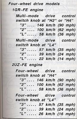

2UZ-FE is the V-8. That 16mph number for the V-8 seems a little odd. I suspect it should read 14mph, as well. That way the low range reduction works out to about .388 and works for every gear.
Thanks JB.
From the chart I does not appear that shift position 4 is available. Isn't 4th available along with overdrive in 4WD (diff locked)?
Well, I guess since 4th and 5th gear both go over the 112mph governor limit in high, and since low is for low speed driving only, they just listed gears 1 thru 3.
