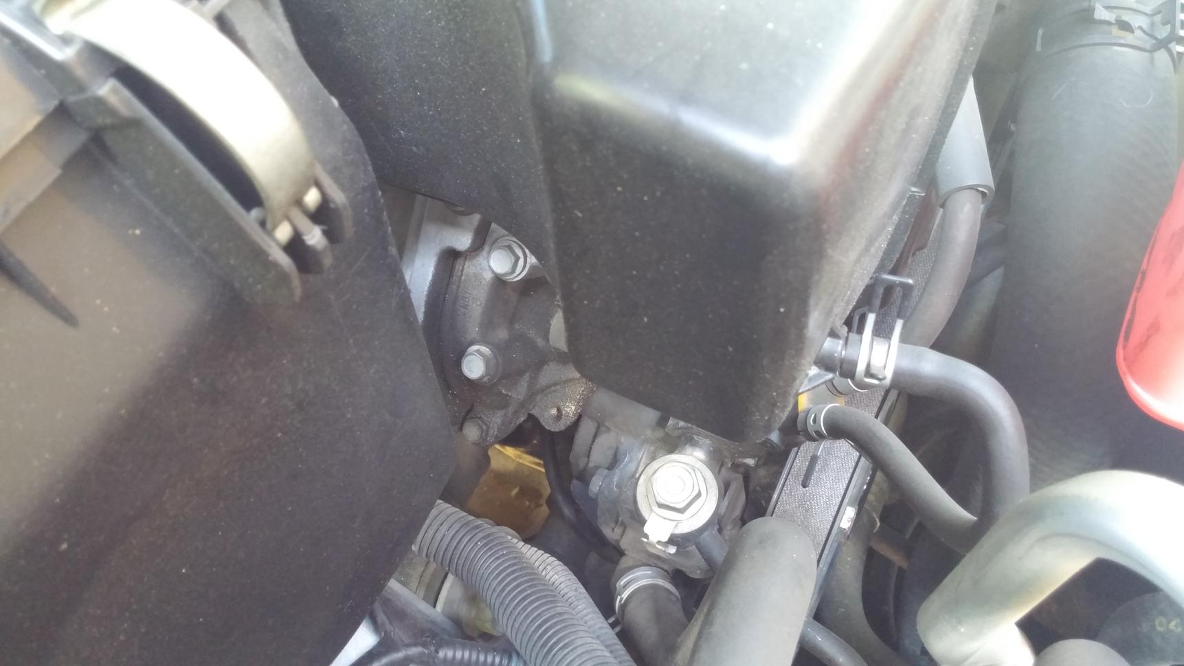

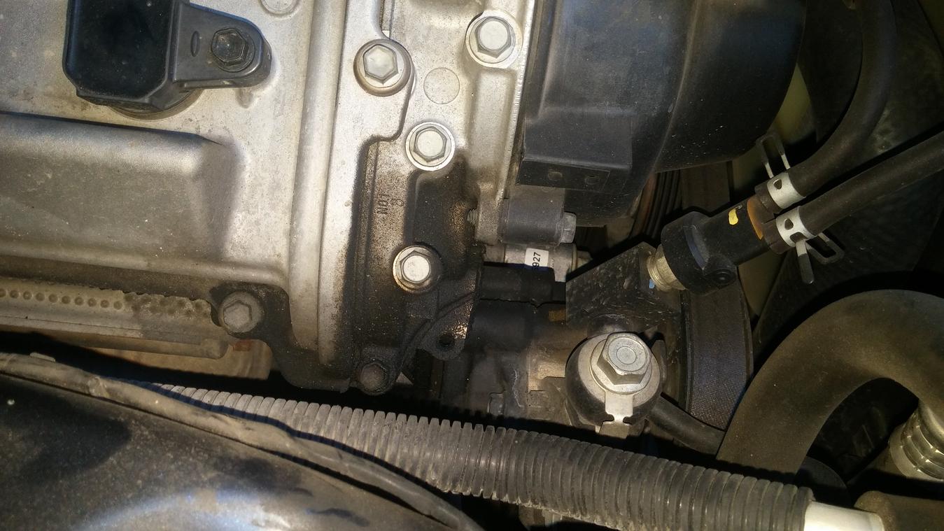

What is this leak/build up?
4OYOTER
4.7, passenger side, above alternator.

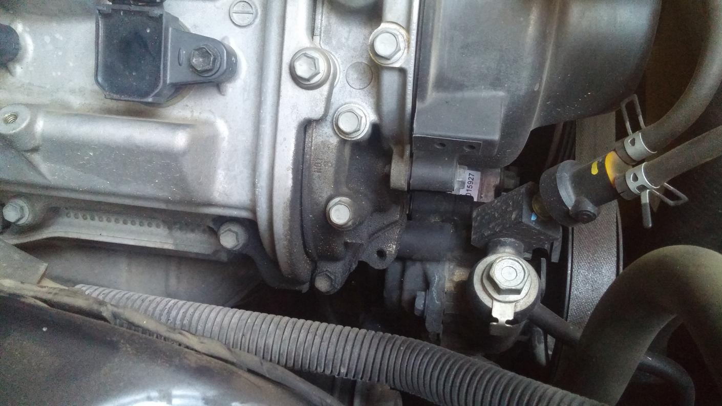

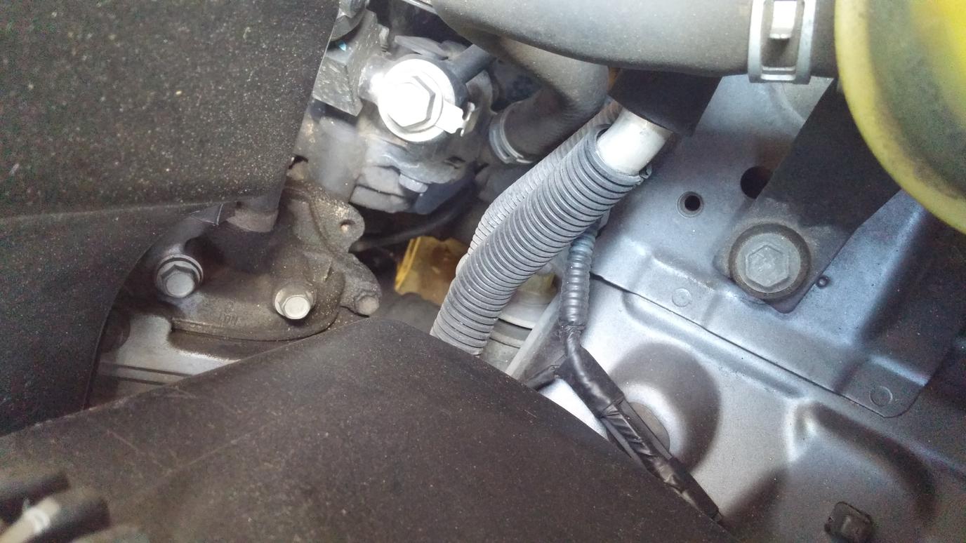

[MENTION=122413]Qlaloo[/MENTION] thanks for the neighborly help! I snapped another picture today while doing my spark plugs. Can anyone confirm this is a valve cover leak?

Actually the valve cover leaking on higher mileage 2UZ-FEs is about the most common leak you'll see next to the factory water pump leaking by the first timing belt change interval (usually the second pump you put on there doesn't end up leaking again). The engines are really good about staying dry/not leaking excessively over time like other vehicles.
Valve Cover Gaskets are easy to do on the 2UZ-FE and the part is fairly inexpensive. Good weekend warrior skill building job. :)
They will probably be loose if you check the torque, but will keep leaking after you tighten them.
