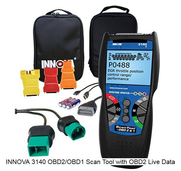

I have been using this scan tool with my Chevrolet Duramax and it is great at clearing codes - which a diesel truck has plenty of. Innova 3150 - Scan Tool | O'Reilly Auto Parts
