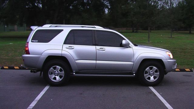

I just got a new set of lt265/70/17 BFG AT/KO's and i have about a 200# system in the back. Im pretty set on using Donahue Coilovers up front, so what do you guys think i should use in the rear? Thankyou in advane for any help!

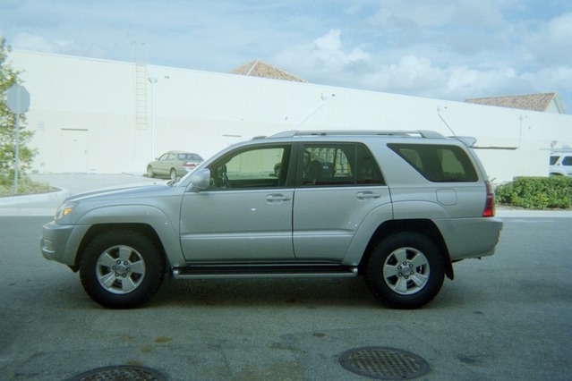

BTW your lift looks awsome, makes mine look like a big car even with the BFG's. What are your front coilovers set to?

Thanks for the compliments!
My coilovers are from Downey Off Road and are set somewhere between 2" to 3". I measure from the ground to the top lip of the fenderwell at 36 3/4" which includes about 1/2" of tire height.
A stock 4Runner is about 2" low in front and you don't want to go over 3" of lift and impact the CV joint angle. So with 1.5" to 2" of lift in back plus weight in back, 3" of lift in front is about right.
My original Downey rear springs were about 1.5" taller but the metal was soft and they sagged and took a set at almost stock spring height. They were supposedly 20% over stock. Downey replaced them but even then I could not heavily load the back with gear. Now I have my highlift jack and kit, hydraulic jack, tool kit, air compressor, recovery gear, water and more in the back without a problem.
I set the front coilovers so that the back was about 1/2" higher without any weight added.
The front sway bar now has spacers underneath the pivot mounts to adjust the height. The back swaybar links are now longer in order to set the swaybar into the normal operating angle with respect to the frame.
You only need longer rear brake lines.
If you are always carrying 200 pounds in back the 15% DR springs might not be stiff enough. I find 30% to be a bit too stiff unless I have an extra 150 pounds in the cargo area. You'll probably want 20% over. Talk to DR about your application and see what they say and how much they charge.

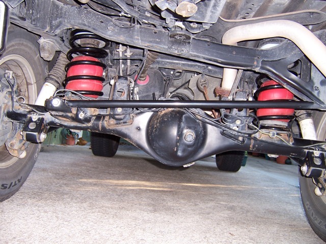

You could max out the back for some heavy hauling. I kept the air bags to use as bump stops. Yet to compress the OME springs that far.
