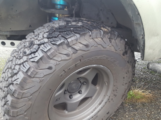

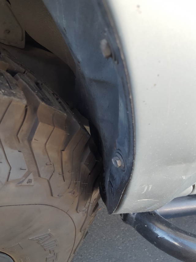

As far as preload, I would say I am almost dead set at 2.5 inches of preload on 600# coils. This gives me 23" of lift, hub to no flare fender. I am running my AOR front plate bumper loaded with a warn winch running steel cable. I also have full Savage skids. I have about 24.5" Lift in the rear witb the 4X Innovations rear swing out and the 861 coils out back.
The G setting work out great. My tires were eating my wheel well up prior to me picking up the 3.5" backspace SCS F5's. So I went from a 4" BS to a 3.5" BS and my wheel well/ pinch welds weren't having it. This gives them plenty of room to move freely without contacting anything.

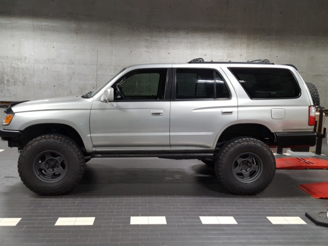

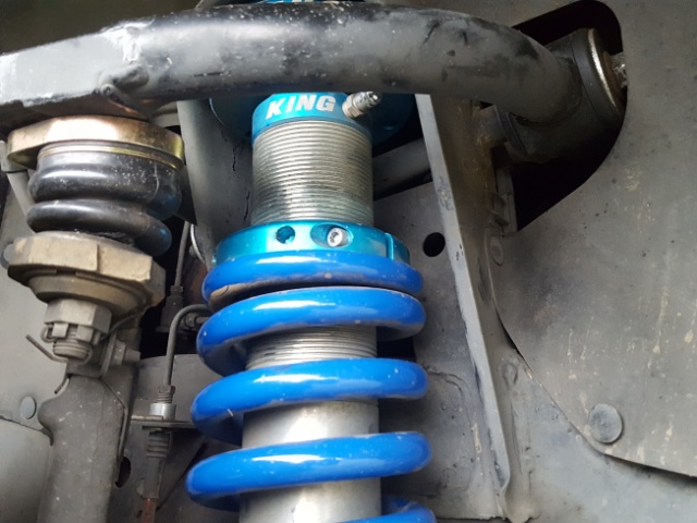

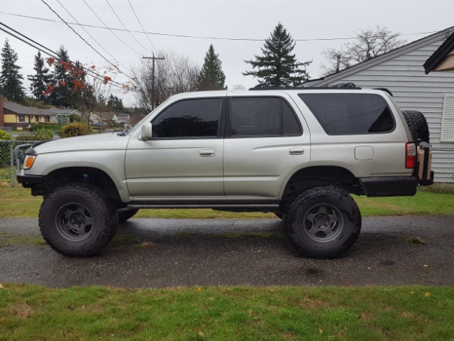

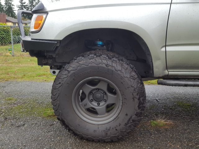

I went offroading last weekend, nothing extreme, but no contact even at full lock. I am super happy with it so far. Here are a couple before and after pics.
As far as the ride goes, I didn't find it harsh at all. But that is pretty subjective. I guess it didn't feel like my shocks got crappy all the sudden, if that helps.

Thanks for sharing. When I saw this pic .... Holy crap ... It looks like you doubled the amount of thread showing. Glad to hear it rides fine. I plan to try and raise mine up at least another 1/2".

Yeah, I like where they are at now. But, yes, that DID get my attention when I saw what, "raise them up and inch" looked like in person. Hahaha.. I would drop them down if I start to get close to level with the 861s as time goes on.
I think they ship with very close to an OEM stock height. That is just a theory. But I raised mine up when I originally got them up about an inch.
