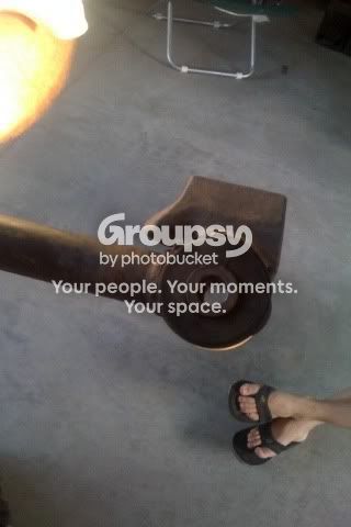

We took off my LCA's last night to weld on the Toytec skid and found this welded to the top of the frame end of the arm.

None of the 3 other 3rd gens that we had there had anything like them.
Thoughts?
My stock LCAs had those and J-money's did too. The only thing I can figure out is they are there to limit the travel.
So what you are saying is that i should remove them right? :lol:
You might as well. I'm pretty sure you'll get some more upward travel out of it. You might have to clearance your driveshaft/gas tank a little more though. I had to trim my Lil skip's tank skid because my home made links don't have those stoppers.
Yep Brian and I had them. they would technically stop the droop at a certain point, but you couldn't reach it with OME shocks. Maybe the the LC trekmasters. Possibly its just a 97 thing. We all have 97's

And the shocks on these truck stop the droop in the back, unless you still have a sway bar. so those metal chunks are really a waste. And i think all the leverage and weight of the axle would just cause carnage on it if you actually used it. The LCA mounts are weak as is
