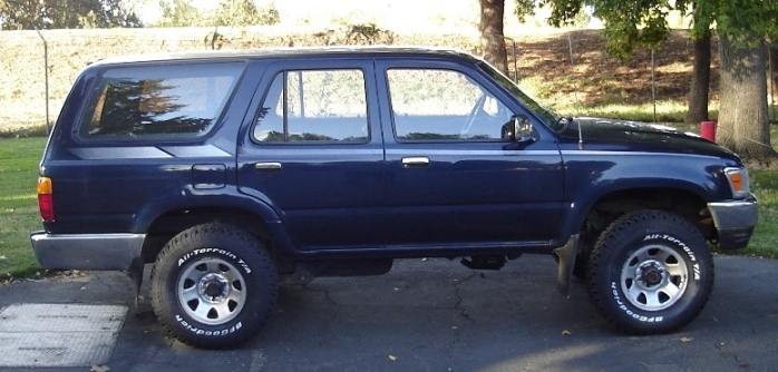

Well I went ahead and bought the BFG 31x10.5 tires today. I got a really good deal on them. They look very nice on my 4Runner. What do you guys think?
That's a clean looking 85 you have there. I guess the tires do look better with the black side out. Oh well, not much I can do about it now.
