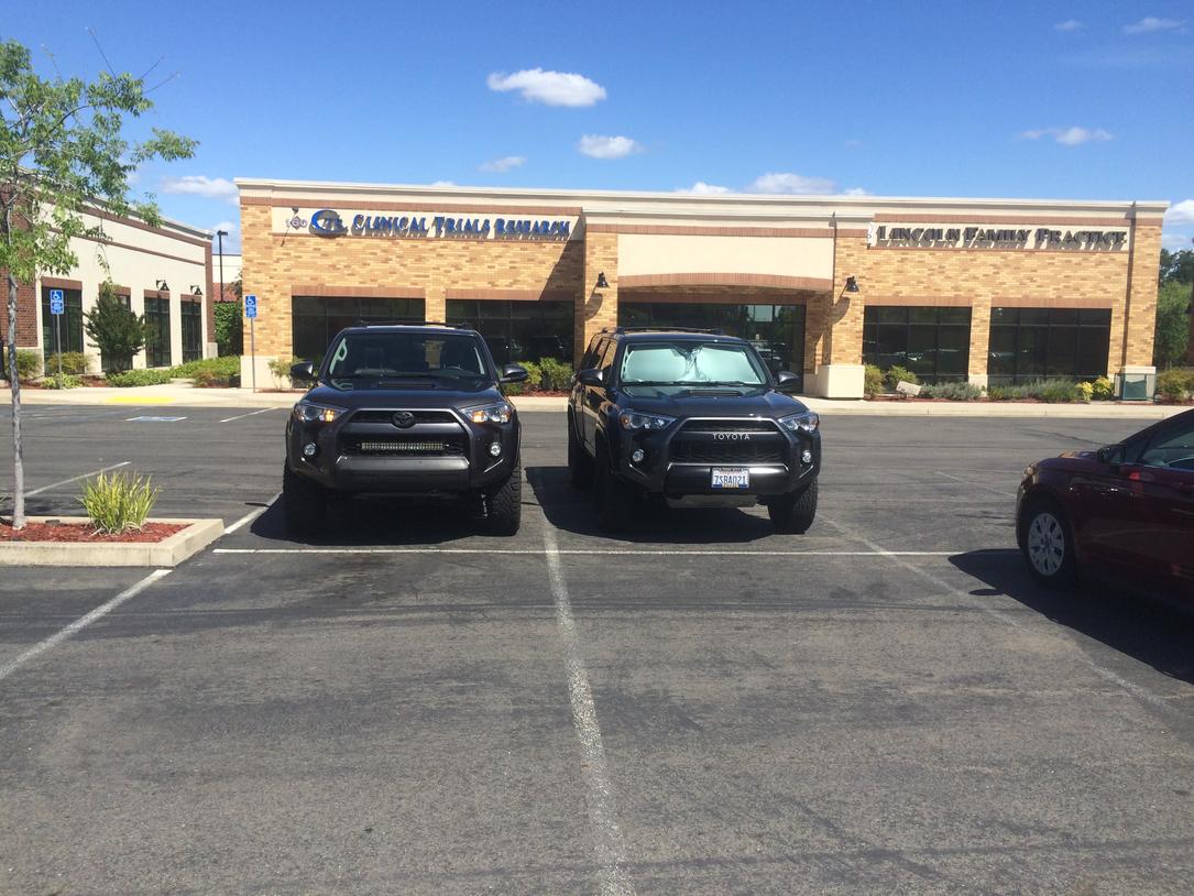

I don't have that specific spacer lift but my experience with a Toytec version of it is that nothing was noticeably different, on or off road.
Have it, bought on Amazon prime and did it in my garage... super basic and IMOP it's how the truck should sit stock.
Parked next to a TRD Pro it sits equal, drive angles are almost flat. Ride is the same as before, with better ground clearance.
Seeing how this was my DD this was the "smartest" "lift" for me.... hopefully to keep me from getting into too much trouble... I have to constantly remind myself that I have a landcruiser on 37's to beat on in the trail :-)
