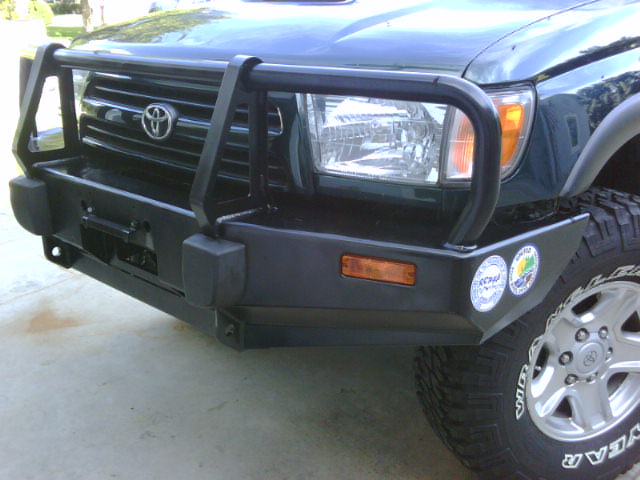

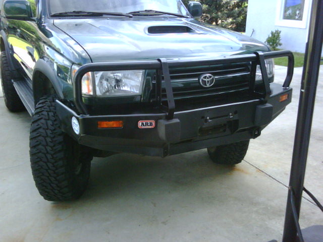

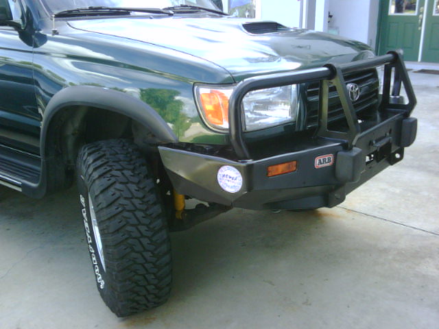

This is Rustolium satin black.

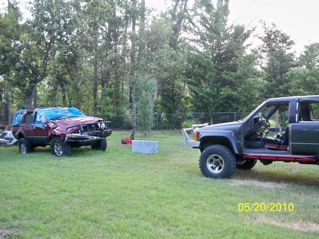

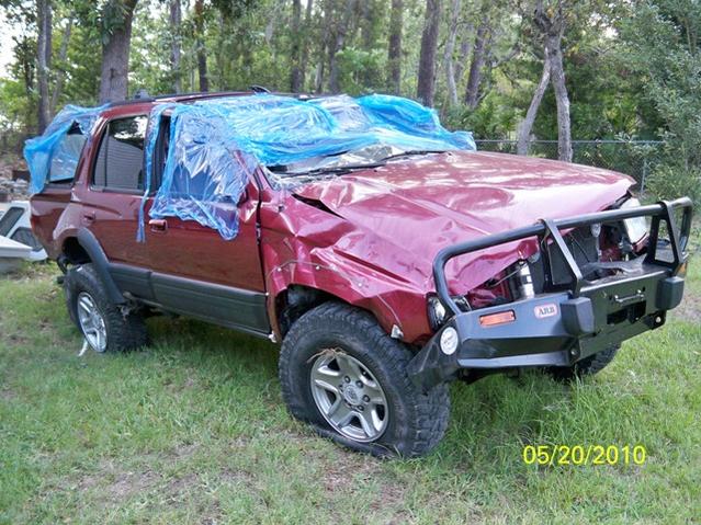

It was a quickie paint job, not much painting prep done, just a lot of bending & hammering. You can see the original paint around the ARB emblem.
Not bad considering what I started with...
