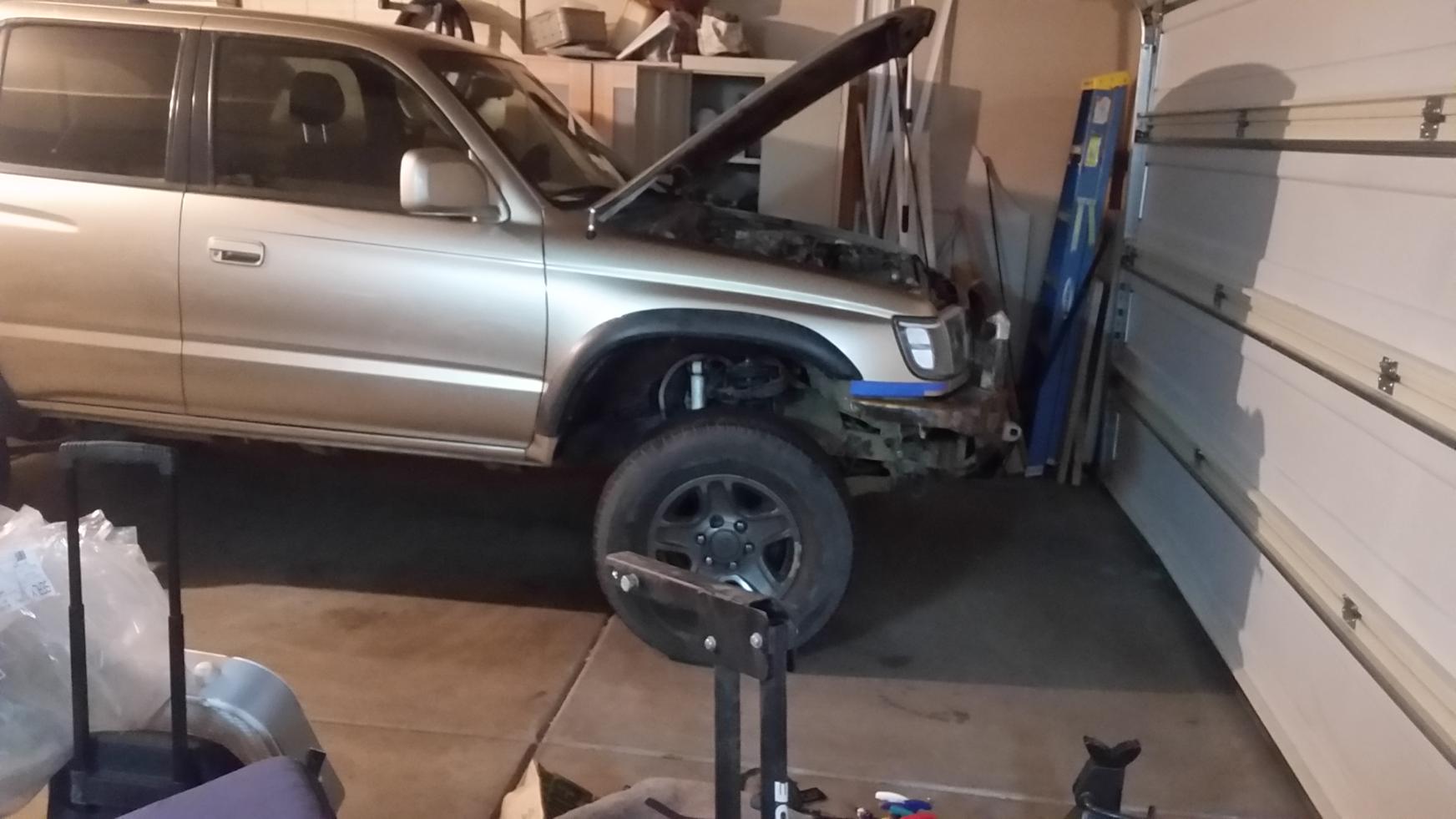

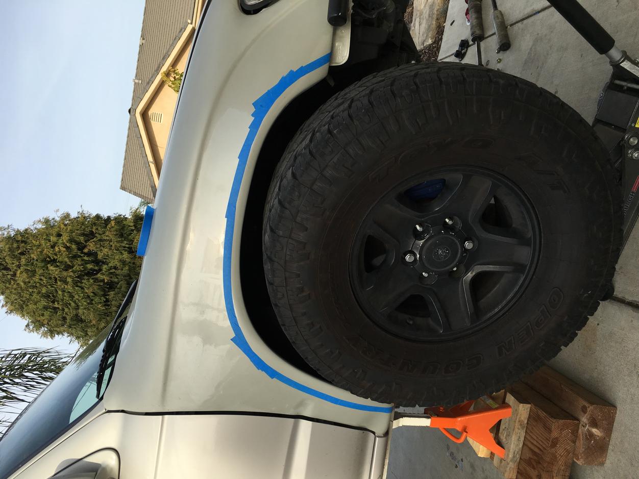

Also, are you talking about cutting the fender itself? Here's what I just did, similar to that?
Grinder with a flap disk and cutting wheel, along with a big hammer. Really the 3 things you need to solve most rubbing issues! Where exactly is it hitting? I assume near the pinchweld?
