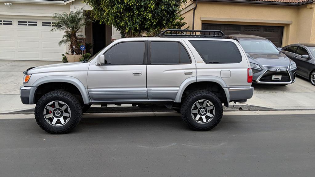

My setup:
Front: Bilstein 6112 - 8th notch, about 2"
Rear: OME 890 / Bilstein 5100, about 2 1/2"
Love it.
