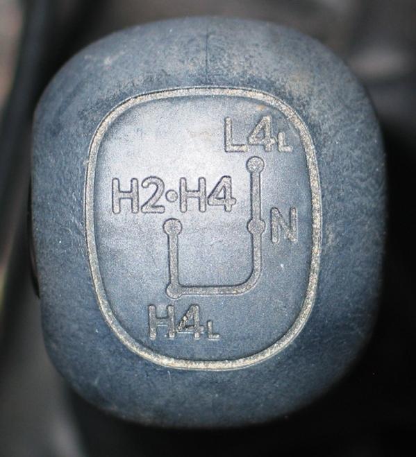

Okay so I am Necro-bumping this thread but I have read a few(Actually a lot of threads) and this one( http://www.toyota-4runner.org/3rd-gen-t4rs/82033-3rd-gen-4runner-buyers-guide.html#post706219 ) came up with POST 3 Being of most concern. Namely towards the bottom, where it says, " -The '99-'00 limited 4runner had both of these if you can find one with the e-locker option." What this is referring to(From my understanding anyway) is both the RR button, AND the Center DIFF locker(ie. the AWD) option.
Now reason for my asking is because, I am looking at potentially purchasing a 2000 Limited with the RR button, But I don't see the AWD button(At least not on the pictures of the vehicle in question)? I am also looking at another dealership that has a 1999 Limited (As well with the RR Diff button), but again no "AWD" button.. How do or can I determine this?
Thanks in advance for your time.
EDIT:
Okay so after searching yet a little bit more, I think I may have found my answer:
http://www.toyota-4runner.org/3rd-g...rs-3rd-gens-transfer-case-awd-multi-mode.html
The Standard "J" Config, except where the H2 is, now there is an H4 next to it, ie. this picture (Yes, borrowed from that same thread, hope it's okay):
EDIT:
If you hold the transfer case lever with your right hand, your thumb will naturally fall to the center diff button. The lever locks the center diff going to H4L. The button switches from H2 to H4. (H4 is AWD, or limited slip differential mode.) Look near the speedo for the 4 wheels and center circle diagram. The tires will change to green when driven. The center circle lights up to indicate a locked center diff, IIRC. (Don't do this on dry pavement!) If the lights flash in unison, it's just not meshing well immediately, give it a moment. If the lights flash out of sync, press the button again immediately, there's something really not right with it.
You can even see the edge of the button in the picture you posted.
