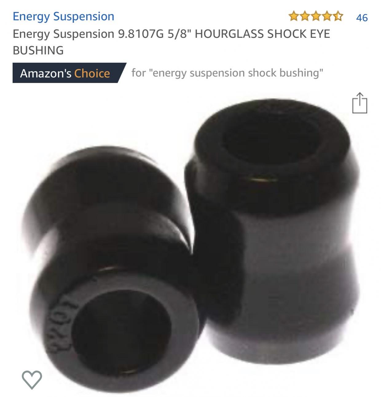

What’s a good replacement bushing for the rear lower shock mount
infamousRNR
Senior Member
Will this bushing work for the lower shock mount?
I have 5100’s and bushings are toast...
What are your thoughts?...
I put a picture of the energy suspension in this post but it looks like it’s not working now...
These are them. Does anyone know if they are the right size???
Energy Suspension 9.8107G 5/8" HOURGLASS SHOCK EYE BUSHING https://www.amazon.com/dp/B000CN9D3K/ref=cm_sw_r_cp_api_i_JWLSDbHX42ZE3
I believe the inner diameter of the bushing needs to be 3/4. I purchased these for my 5100's and they fit fine.
https://www.amazon.com/gp/aw/d/B004IARRGI?psc=1&ref=ppx_pop_mob_b_asin_title
These are Daystar bushings, but I believe I seen energy suspension have some in red if you dont care about color.
Yup I did the same mistake too. Tried to hammer on the 5/8 hourglass shock eye Energy Suspension bushing. The 3/4 id ones mounted perfectly.
