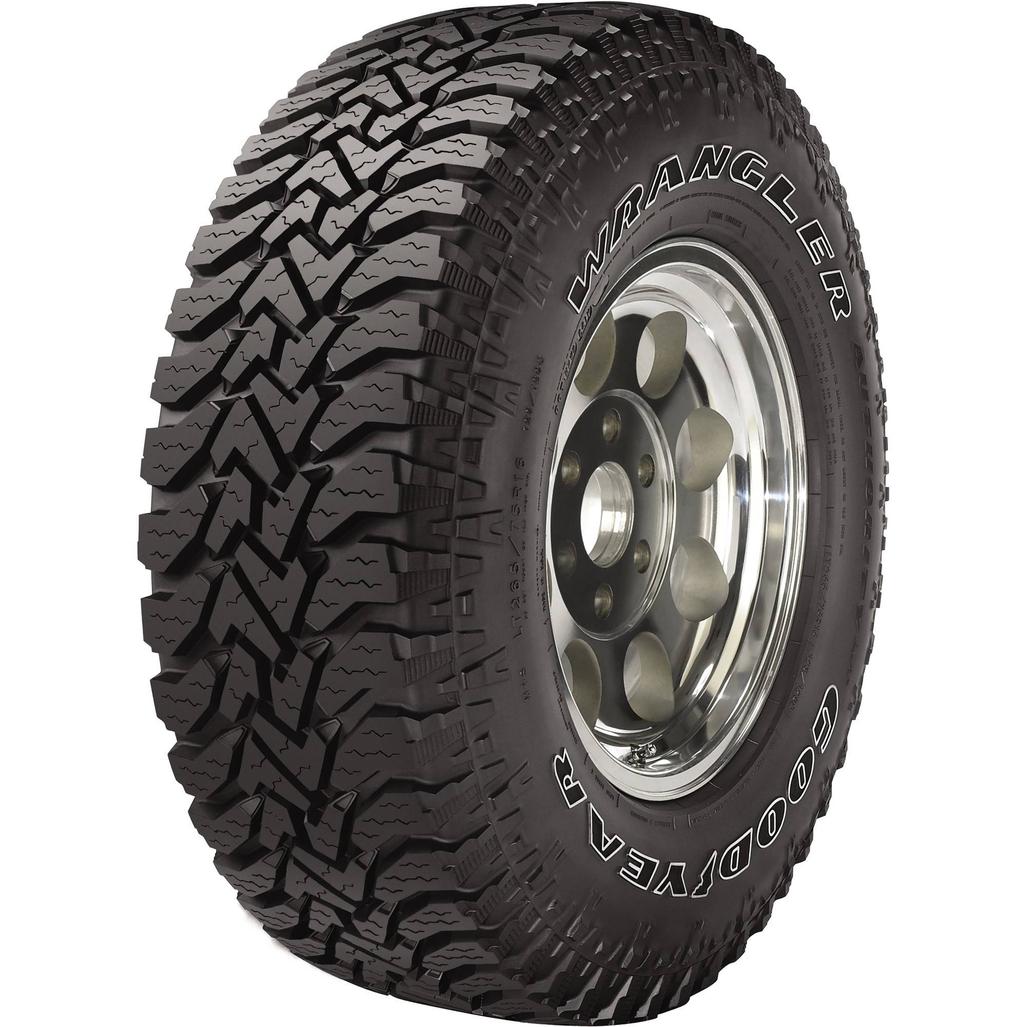

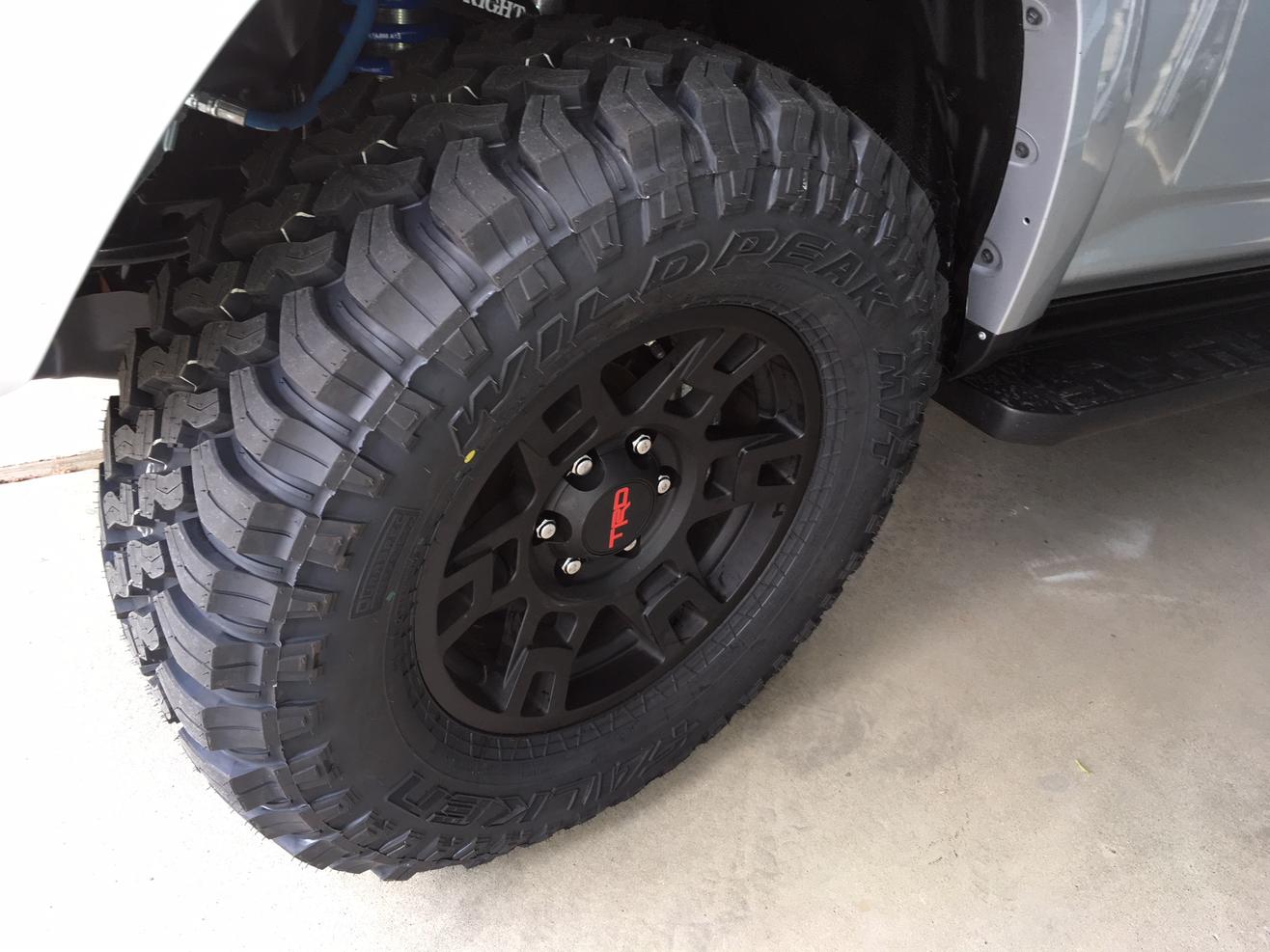

I don't care much for wheels since all wheels are round and spin with the tire but I would aim for the lightest wheel with proper backspacing.
As for tires, I have gone through a boatload of tires since the early 2000's. I am one of those dumbasses that wastes money by buying new tires every few years even if my tires are not worn out...cuz I get bored. :crazy: However, about 5-6 years ago I came across a tire called Goodyear Authority and bought it for my TJ. It performed so good in all conditions, including snow and mud, and I could find no faults in it. It was so good that I bought it for my XJ, and also for my 4runner. It excels in every condition, is predictable on ice, and wears very slowly. It's also cheap and can be found locally pretty much anywhere.
If you want an aggressive all terrain tire that is dressed like a mud terrain and performs exceptionally well in all conditions then try out the Authorities.

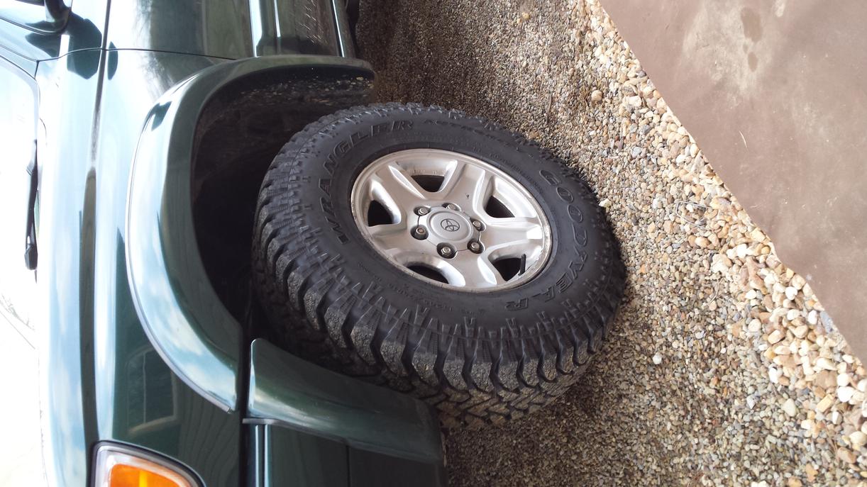

Here's a crappy pic of the KO2's on my 3rd gen.
And a pic from the google...
