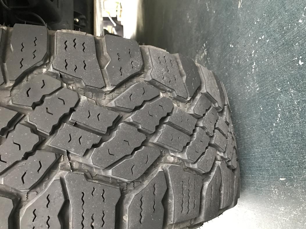

Cupping or feathering? Pics?
I assumed cupping. Not sure if you can see in this pic but you can sort of see the light and dark on every other tread. This has made them unbearably loud in highway use. They have been amazing tires, just the bad wearing it's time to move on. I don't blame the tire until I get an alignment and if that looks good it could just be I didn't rotate enough.

Yep thats cupping alright. A friend of mine has the same tires and they are cupping also. While rotations and alignments are a main factor when it comes to reducing this issue, some tire designs are just more prone to cupping.
