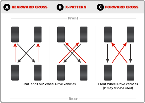

also, I agree with the above, you want to cross rotate them to the back. this will help flatten them out, and keep them flat.

shock wear is something different. similar, but looks different. cupping happens from lack of rotations.
