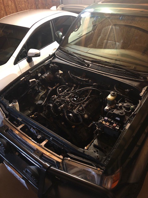

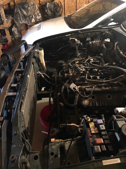

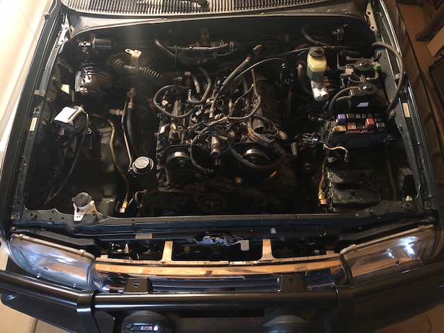

Ok so, I have been dealing with several issues on my 2000 4Runner 4x4. It started with rough idle, that led to coolant disappearing and check engine light. After running codes and attempting to fix the issue, I came across some major problems with the 5VZFE. Long story short, I decided not to proceed to fix the issues as the motor has 200k+ miles and if I am going to spend money on this motor, I might as well get another lower mileage replacement. So, I have started taking apart the engine bay to pull the engine. I have gotten as far as removing the radiator, fan, battery, etc... and just need to unbolt the trans, exhaust, and engine mounts.

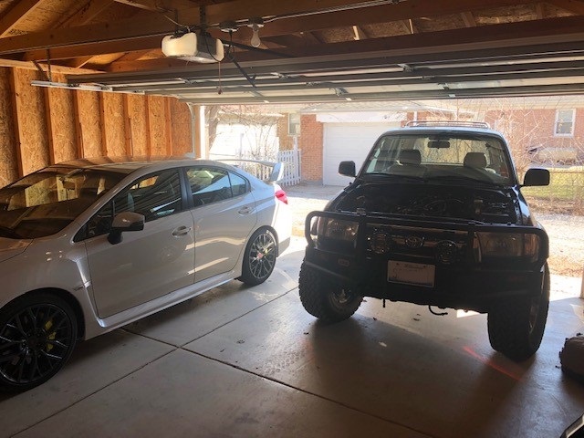

Here is where I am now (ignore the 2JZ and K24 in the background...those are out of the question):

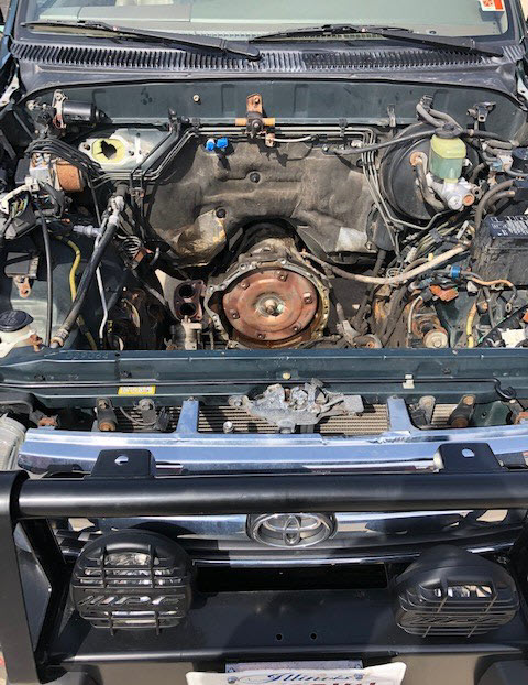

Motor is out! What a pain in the @ss!
With the 5VZFE out now, I really really want to mock up a 1UZ in there or an LS....but, too many other things to change if I go V8.
I think building a stronger 5VZFE (studs, bearings, etc...) might be the better route.
