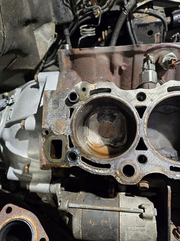

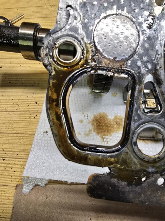

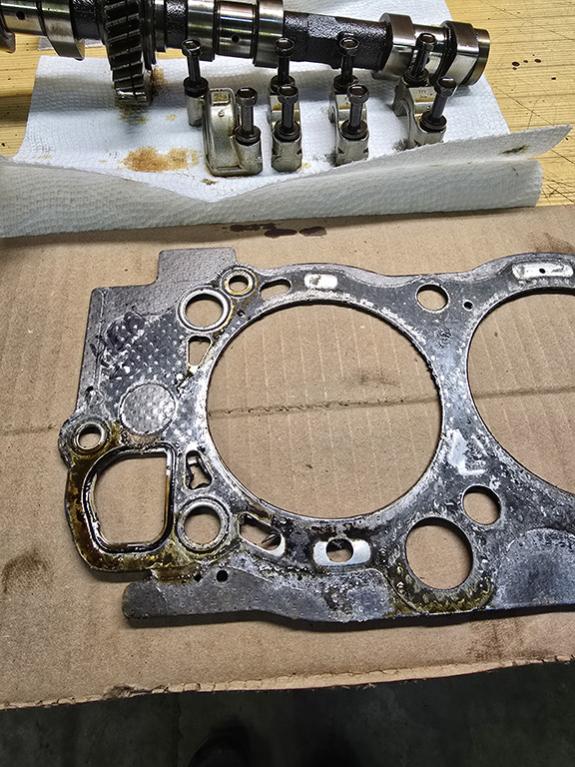

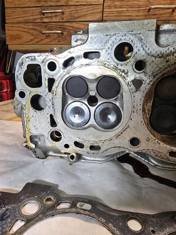

Well I got the heads off yesterday. Totally forgot in just 6 months how much crap needs to be removed to do this job. There was coolant in the #5 cylinder as I thought. The gasket was actually a composite type gasket (fel-pro) I’m pretty sure. I can’t see anything glaringly wrong to be honest but I’m admittedly lack in ability to diagnose a bad gasket by just inspecting? I checked the head as best I can physically and do not see any obvious cracking?
My machine shop guy told me to bring him the heads and he will go through them to make sure they are still good. I have to clean the deck surface of the block up and check it for any warping still. I’ll post some pics shortly they have to be resized.

I see nothing glaringly wrong with your pics EXCEPT maybe that the block wasn't very clean near the edges? Scrape it clean, and then an old large FLAT honing stone run over it helps to see if there are any dips or peaks. No scotch brite pads or any flaky abrasive crap please. ( dont "roadkill" it!) Also, don't know if those head bolts go into coolant passages, but ARP thread sealant is your friend on assembly.
