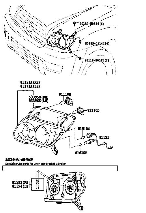

I just did a headlight swap on my 04 with the 06 hid projector. There are two bulbs on the corner, one for the parking(168) and the other one i believe is for the turn signal...what is the part number for this bulb? thanks. and can you replace it with an led one? thanks again in advance.
81510C:-
90981-15022 BULB (for front turn signal lamp)
81610F:-
90981-15012 BULB (for clearance lamp)
here is link
thank you very much. is there a layman's term for this part number for buying outside toyota? like is it 168 or 3157 or 4157. thanks.
