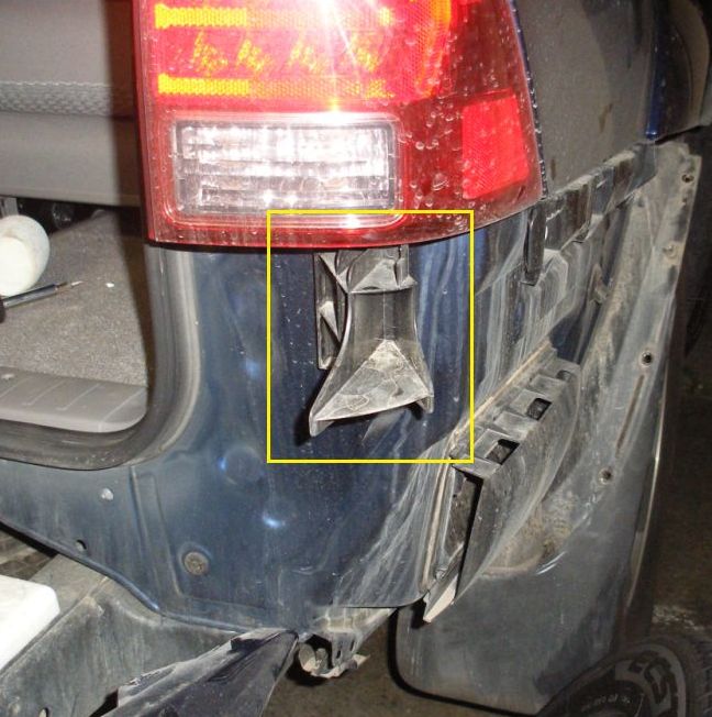

I damaged my rear bumper and need to order replacement parts. I broke the left version of the bracket shown in the picture below, but can't seem to find it on the Toyota part ordering sites (Partznet, etc). Does anyone know what the part is called, or its part number? I have a 2008 SR5 with the tow hitch.

Is it the 52587 on this parts diagram? Part number just to the right...
http://www.toyodiy.com/parts/p_U_2007_TOYOTA_4RUNNER_GRN210L-GKAGKA_5253.html After using this site I then found this...
Collision Catalog
Item Number MSRP Core Price Price
5258735020 $39.41 $0.00 $29.95
Rear bumper - Bumper and components - Upper retainer
Upper retainer Right - 2006-08 2006 - 2008
Add to Cart Contact Us
OEM Catalog
RETAINER, RR BUMPER
DISLAIMER: Please search that part # and look at for youself to make sure I did it correctly. I just 'found' this site. They don't sell parts. It's just a very cool catalog. http://www.toyodiy.com/parts/
:cheers:
YES! Wow that's an awesome site! The only exploded diagram of an 06-08 rear bumper was on Partznet, and it didn't include those brackets.
And wow, $30 just for that bracket. Sigh. At least the bumper is relatively cheap, I found it for $178. Getting it painted will be spendy though.
