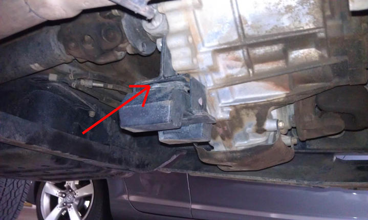

S Skyehunter New member Apr 11, 2012 #1 98' 4Runner - Auto trans This is attached to my transfer case and the bushing is toast. Looking to find out what it is so I can replace it...Also curious as to what it is for? :thanks: Attachments whatsthis2.jpg 45.3 KB · Views: 232
J-money$$$ New member Apr 11, 2012 #2 Its supposed to be a harmonic balancer. I took it off and threw it in the trash long ago and couldnt notice a difference. Just be carful if you take it off. Its heavier than it looks and may want to hit you in the face
S Skyehunter New member Apr 11, 2012 #3 Did you take it off a daily driver or trail rig? I was thinking that was what it was for, and with the rubber being broken I suspect it isn't providing any vibration protection :girl:
Socco New member Apr 11, 2012 #4 x2 on the harmonic dampener. Pull it off. You wouldn't notice if it fell off anyways (unless you drove over it)
