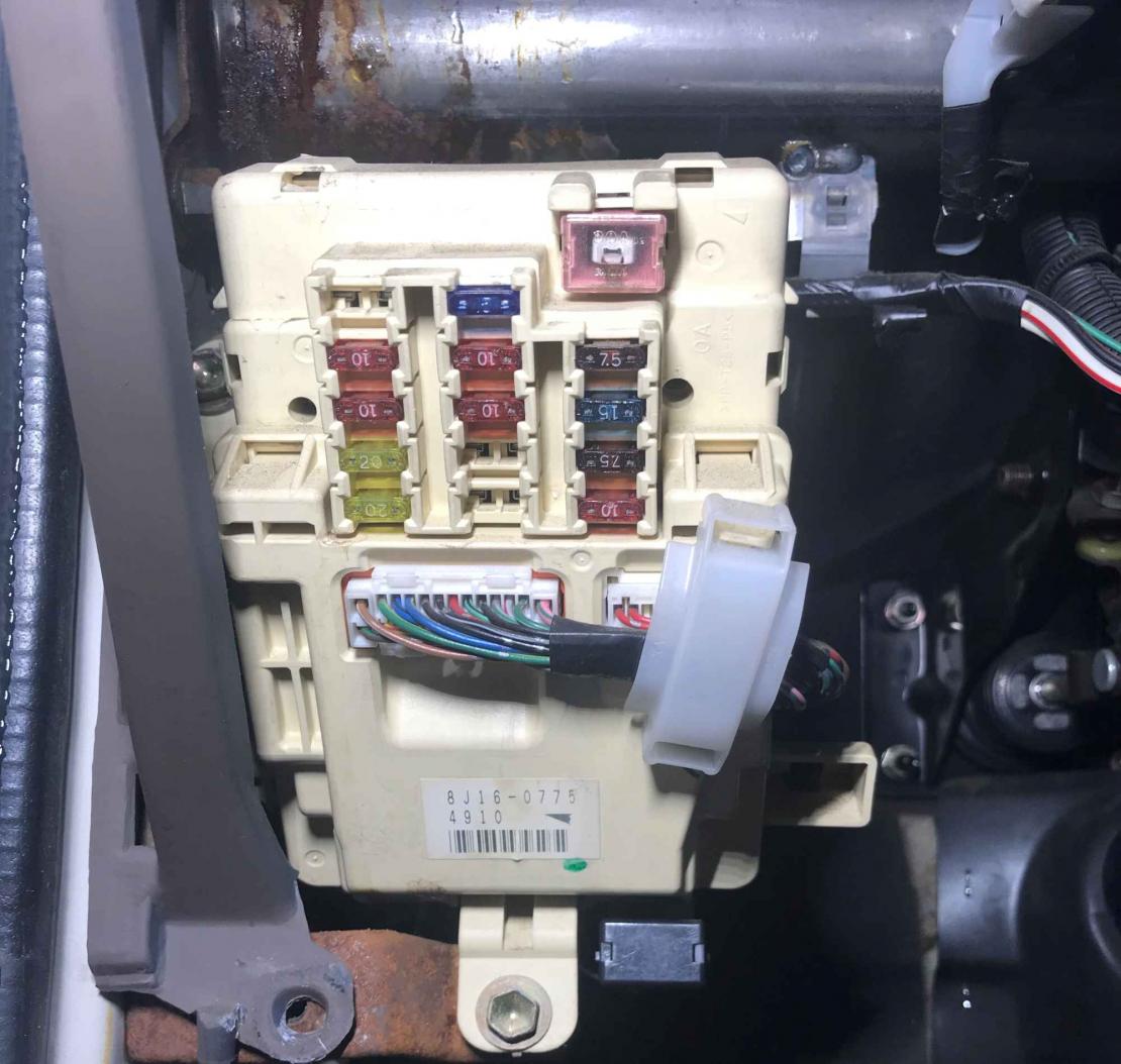

Did you pull the driver's side knee bolster panel down? Typically that lower removeable panel has to be removed to install or remove a remote starter.

Would it be possible to post a pic on here of your wiring?
Especially around the fuse box area?

Fuse panel
I can only get 1 pic to work
