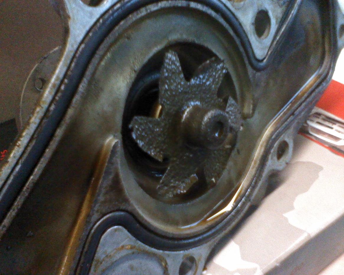

though, I HAVE seen a case where the fins on the water pump impeller actually disintegrated, and had the same symptoms. higher rpms would push the water, and give some heat, but not at an idle.
