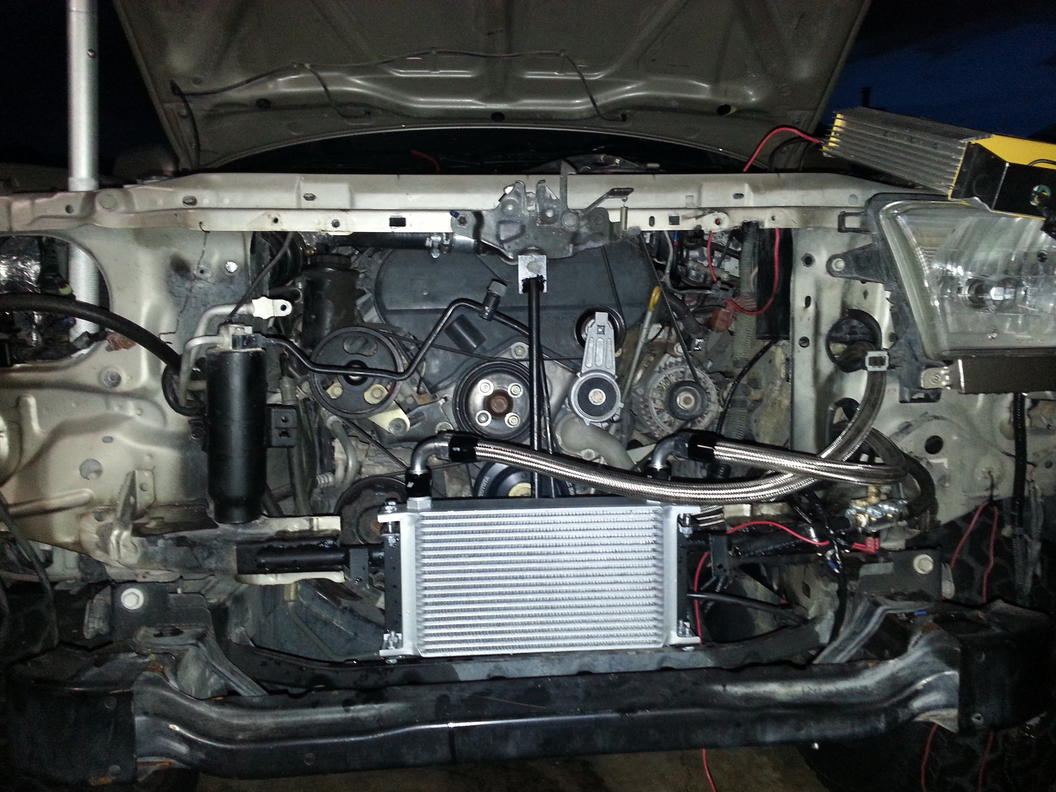

Hey guys I just added a engine oil cooler. I tapped into the side of the oil filter sand which adapter for the temp sender. Just normal driving my water temp stay at 170 and my engine oil temp is at 240 is that normal for these engines? Does anyone here have a engine oil temp gauge on there 4runner?

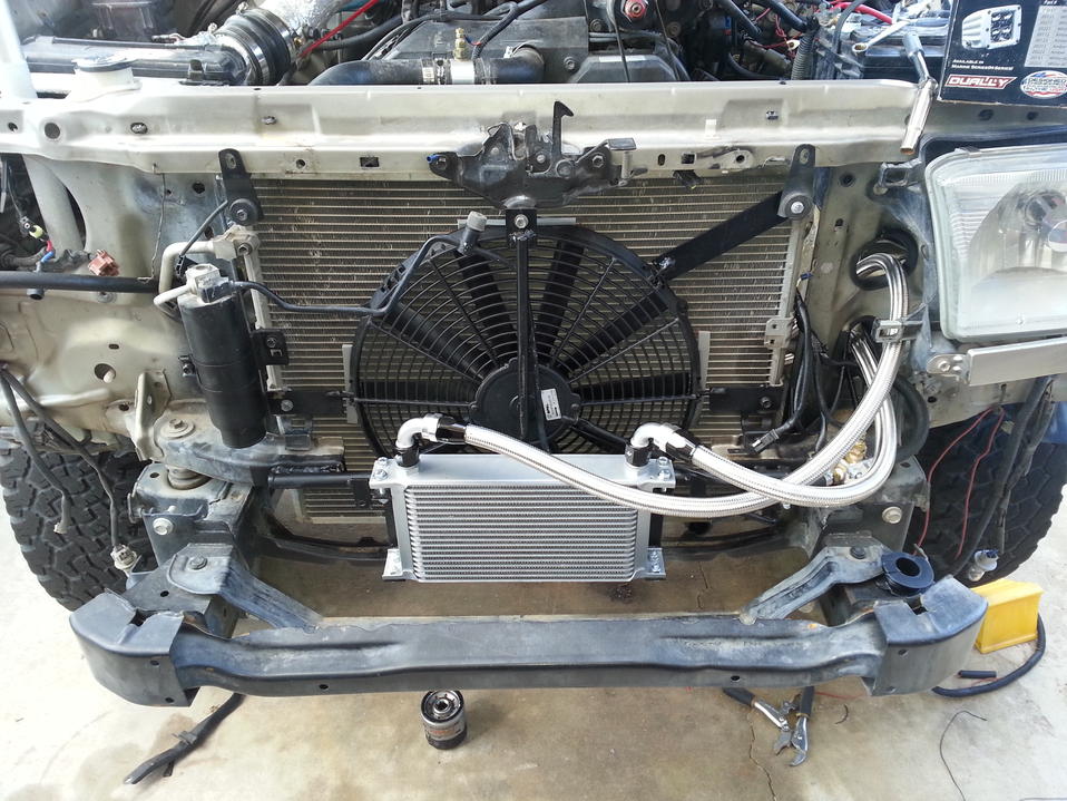

Awwww, now I see the fan peeking out from behind there. Looks like there's enough cooling being done in there to keep a nuclear reactor cool! Go big or go home right ; )
Nice pipework but I am wondering why you felt like you needed an oil cooler?

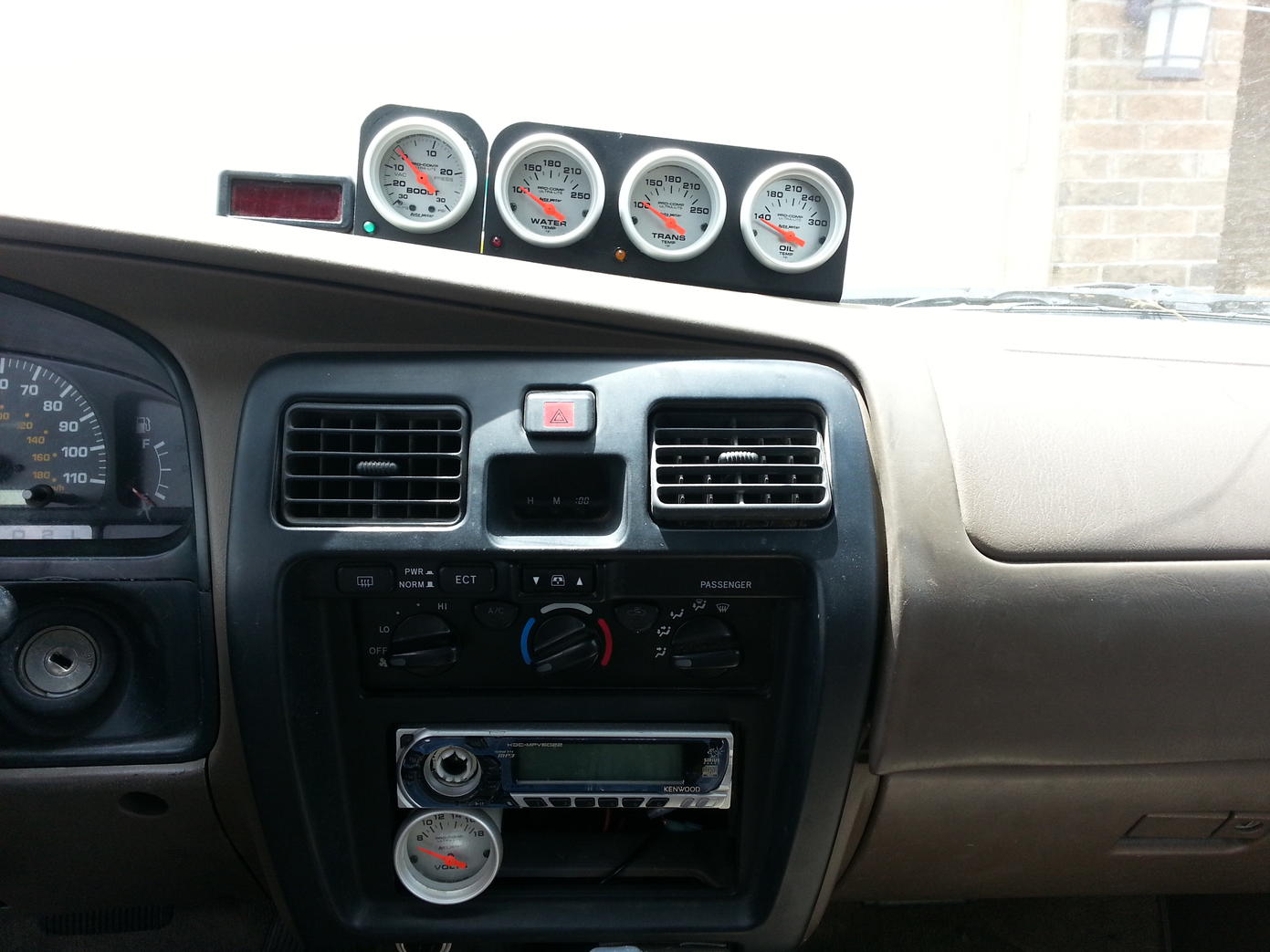

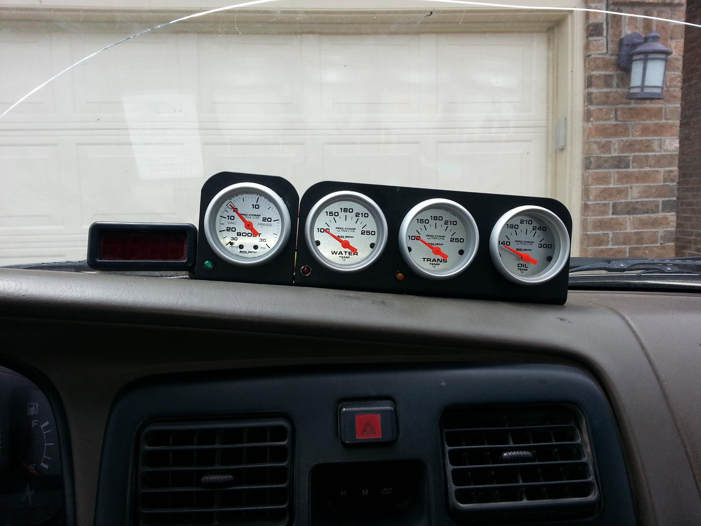

Yup I just mounted all my gauges to the dash to make room for 2 more gauges underneath the radio. On the dash I have a air fuel ratio gauge, boost gauge, water temp, trans temp, oil temp and 3 led indicators green for meth injection activation, orange for pusher fan and red for radiator fan. Im adding a oil pressure gauge and a fuel level gauge when I put a fuel cell in the rear where the spare tire was.

Heres a better pic of the fan yeah I figured go big while everything is taken apart and overkill.

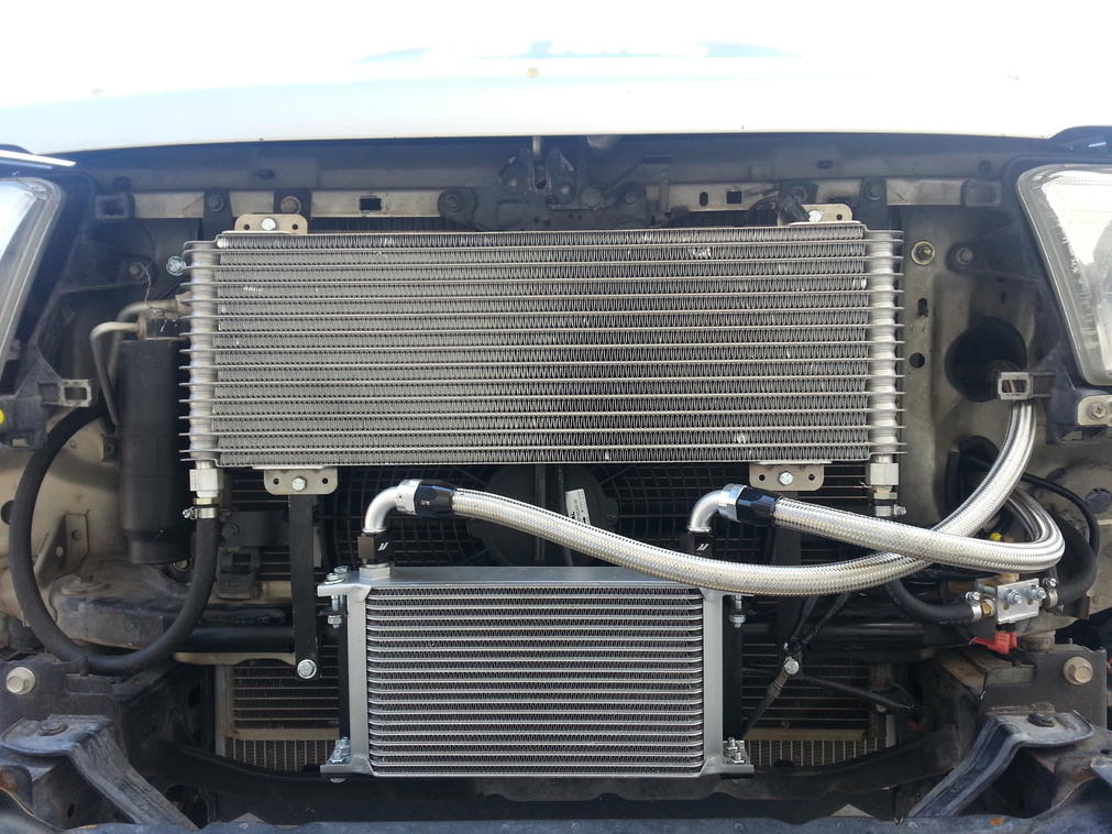

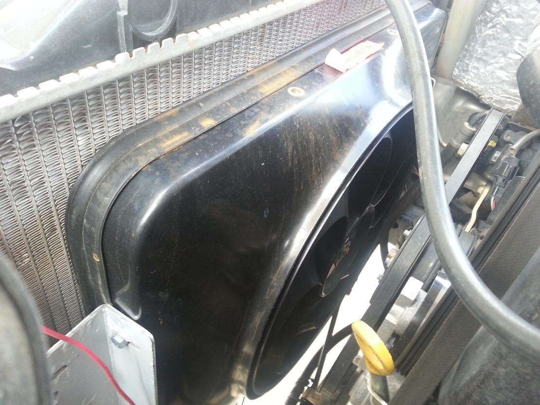

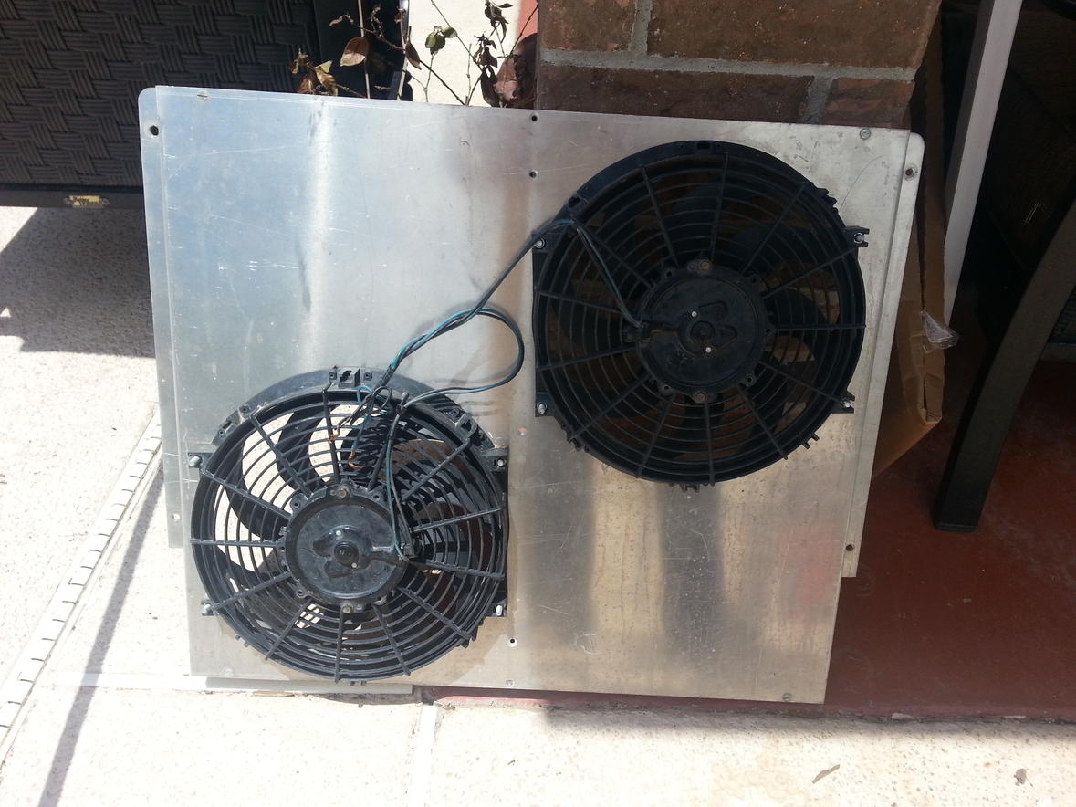

I wanted to add the oil cooler because ever since I got rid of my mechanical fan nothing can keep it cool it always over heats I have tried both these combination of electric fans and nothing works.
Did you verify you're pumping out enough juice to run those fans right? Seems to me a cleaner solution might have been to put the mechanical fan back in.
Is your oil still at 240F with that oil cooler?
I wouldn't worry if 240 was the max you were seeing while going up a hill with a full load, but if your seeing that just coasting down the highway you need to get it cooled better. I have no idea what temp a stock 4runner see's but my car, with an oil cooler, bouncing around off the red line for 20 mins on a track day barely get's over 200. I would not be comfortable seeing 240 all the time.
Its only two fans I dont think its to much power draw on the alternator. I have thought about putting my fan back on but the blades are broken so I would have to buy a new one and I also hate the power loss when it kicks in.

Yeah its always at 240 to 230 I did run it a little hard yesterday in the sand and I forgot to turn the fans on for a little bit water temp went up to 210 but oil temp never went up above 240.
