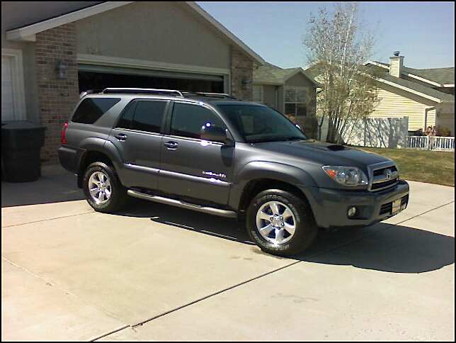

I want to put new headlights in my 08 runner but I'm not sure which ones are good and which ones I'd be wasting my money on. I don't want the whole headlight assembly, just something like the hyper white bulbs. Any suggestions?
