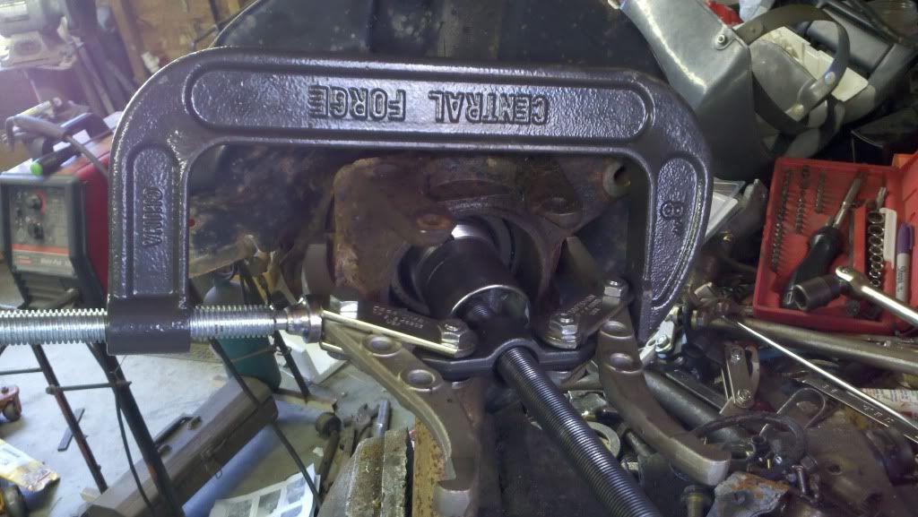

I used a puller and took my spindle right a part.
asisinlock6.jpg~original
Need a press to put things back together though.
