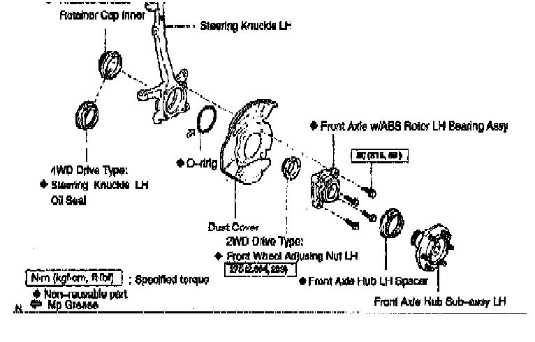

Here is a pic of the set up.
i used to do this in my hondas all the time. its not that hard and looking at the diagram. it doesnt look hard at all it looks like a and old accord. all you need to do is pull the hub bearings and get them to a bearing press. Machine shops have them and i used to get charged $30 each to press them in. i remmber autozone had a warranty on their bearings and kragen didn't . so i would go and ask for the warranty. especially if you dont go oem. hubs dont go bad unless they are scratched or pitted. Your mechanic will know ryt away. pm me if you have any questions.
just try it if your gonna run 20's this might be a norm for you. i was doing it on an accord with 18's. its not that hard and if you can do brakes you can do this. its just a couple extra steps and if your 4wd drive you will need a hub socket and a pittman arm puller. that autozone rents out for free.
