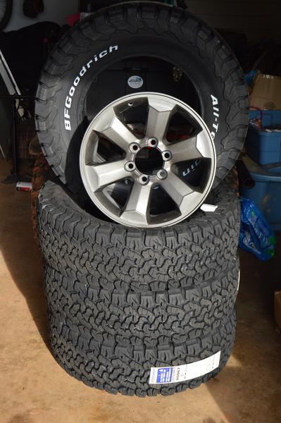

My wheels turned out as good as or maybe better than new. Before and after pictures:
The before photo already had the Rustoleum painted on the corroded areas that I posted previously.
Use the link in my 8/15 post or check here for a location near you
http://www.awrswheelrepair.com/locator
Dropped the 4R off at 4:00 Tuesday and it was finished and ready to be picked up at 10:00 Wednesday morning, yes they work all night.
