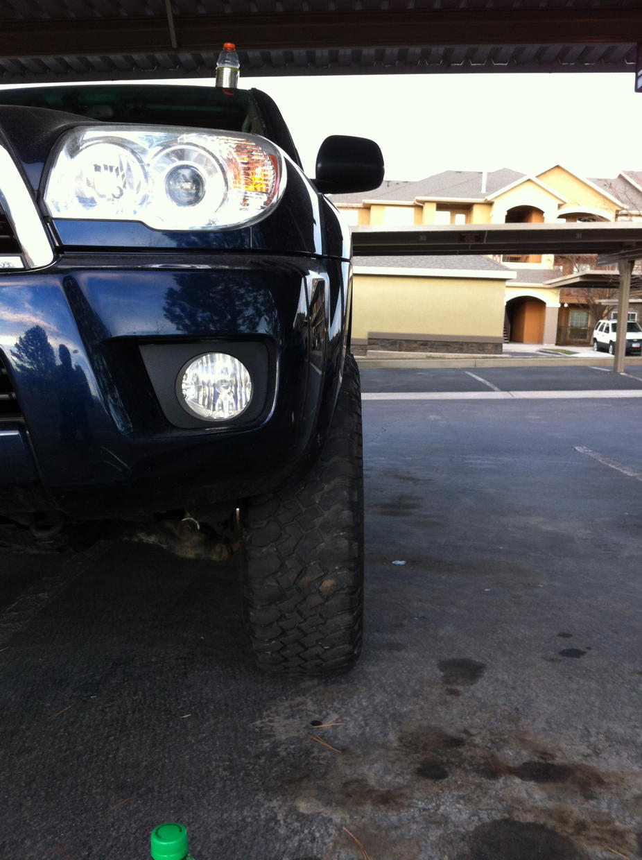

Can anybody tell me the offset of my 2006 SR5 4runner wheels running 255/75/17, and some NEW FJ wheels with posibly 265/70/17. Looking to put the FJ's on. Was going to get the 1.5 wheel spacers, but if I go with the FJ's will I need the spacer to get the same stance? Would like to know the measurements.:peace:

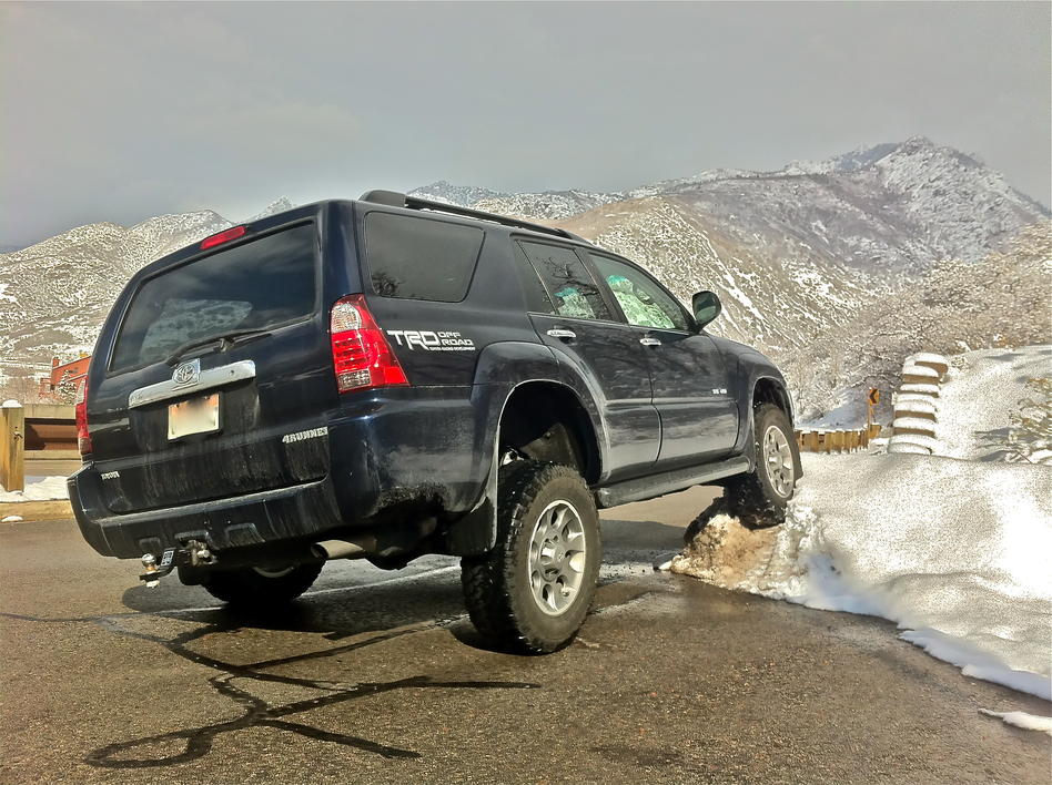

Well I got the wheels and they are 15mm different or .59" They do give a little better stance but mainly just look better.:wow:

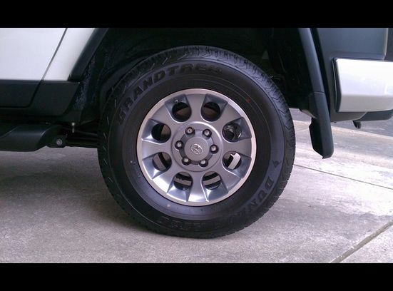

The wheels are a direct bolt on it's like the FJ wheels were made for the 4R:)
The FJ wheels weight about the same as my SR5 wheels did. I sold my SR5 wheels locally for $275 no TPM sensor or stem but I gave them 20 lugs.
I paid $550 with 24 lugs and stems for the FJ wheels they were brand new take offs from a 2012 with about 5 miles. From what I have seen $500 to $600 for a new set is average. You dont need spacers but they sure do make it look better. I'm waiting on some 1.25 spacers from All-Pro, They are on backorder as usual! You get a good price from All-Pro, I had got them 20% off but you have to wait a month to get them! They don't tell you this unless you ask and they don't tell you what the shipping costs are either:mad:

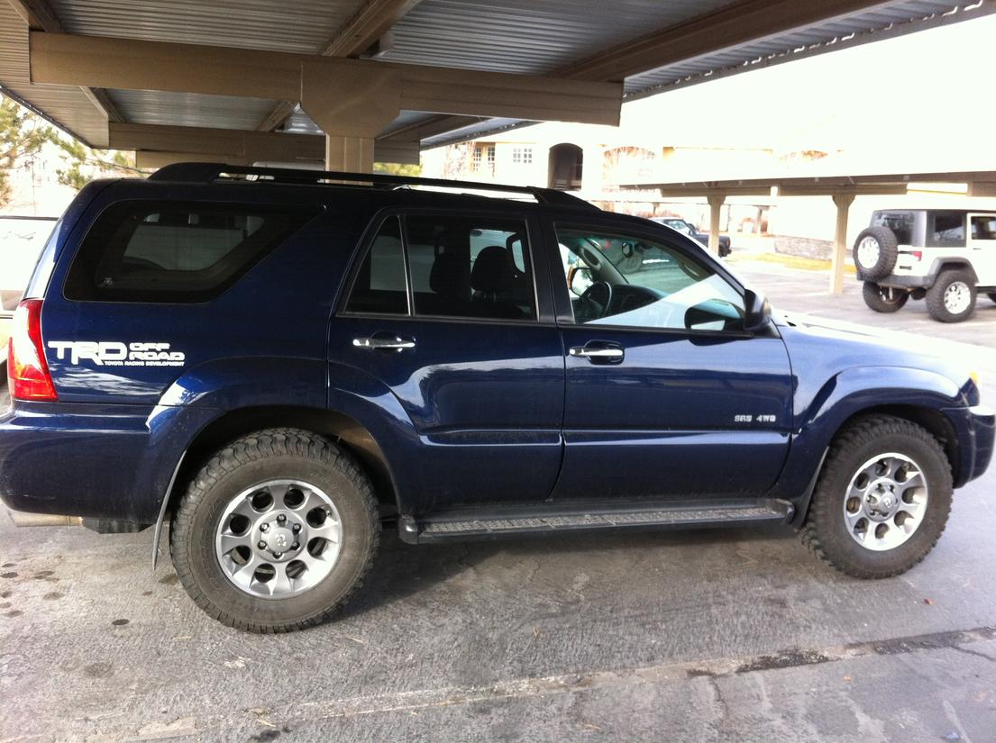

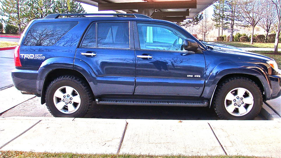

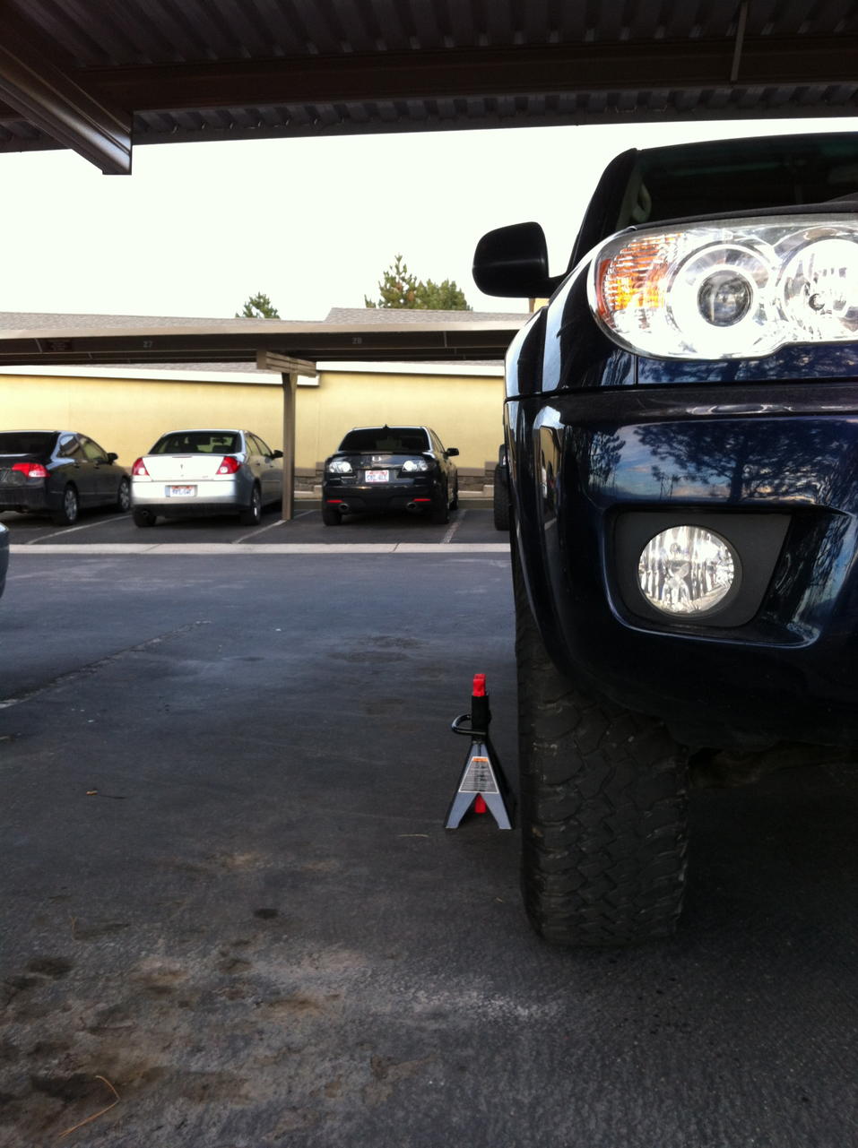

Put my 1.25 spacers on this last weekend and it looks good. I did have a pretty good amount of rubbing had to move the fender liner forward and take off the front flaps to be safe they were super close to rubbing. It was much worse on the passenger front. Here are some pic's, 1st without 2nd with spacers.

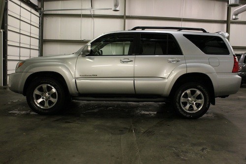

With 2012 FJ Rims
Got these with tires at a great deal!
Now lookn for my next mod.......hmmmmmmmmmmm
I'll get bigger, better pix soon!
