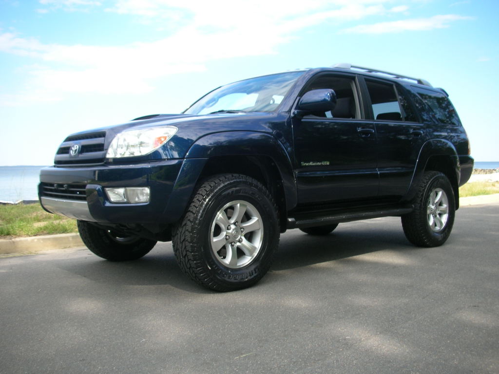

I've got the 285/70-17's on my 04 Sport and I only had rubbing on the plastic parts in the wheel well. The tires fit on the stock wheels fine.

You have a body lift and wheel spacers. If not for those upgrades your 285s would be rubbing all over the place.
I think a stock 4Runner cannot go higher than 275-70-16 or 275-65-17 without rubbing.
