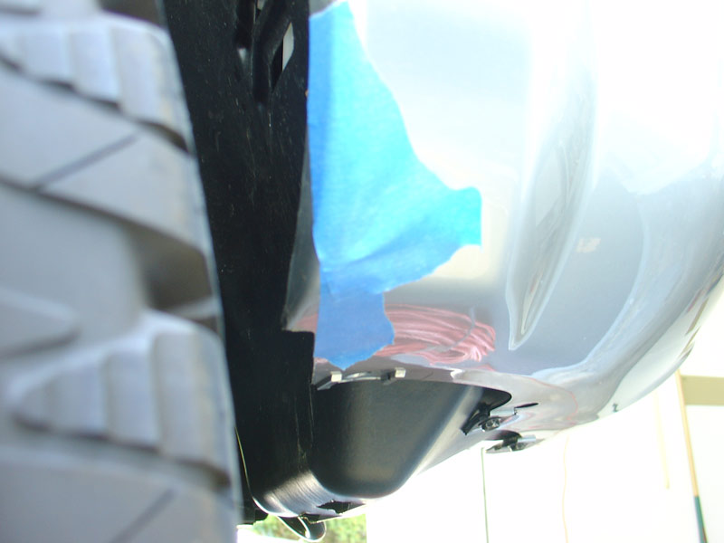

I'm currently completely stock and have yet to install a 1" thick (~2" lift topout) spacer for the front.
I have 1.5" wheel spacers that I was going to use in addition to 265/70/17s.
Have people had issues with rubbing AFTER the installation of the wheel spacers?
Thanks.
Yes, rubbing will most likely occur. In addition to moving the wheel well liner forward, you may need to trim as pictured below and described here.
