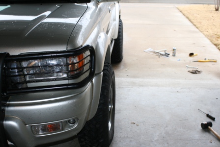

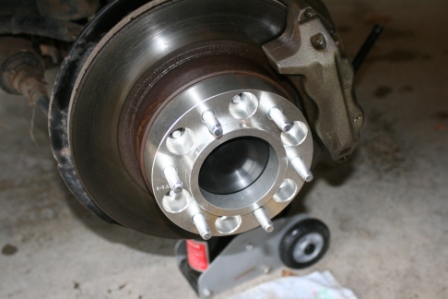

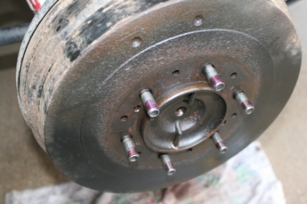

I got a set of All-Pro 1.5 from CHristmas and love them. Better handling going around the corners, ....., and just feel more solid on ground. Main thing is the looks and the stance. They only offer sizes from 1.5 and up. I saw someone, I thought it was Spidertrax, that offered smaller sizes, but I could be wrong. Here are some pictures of mine before and after.

The first small picture is before adding the wheel spacers. When installing, make sure you clean the surface real good to get a tight fit (PB Blaster, wire brush, etc..). Also put some RED threadlock on the spacers before bolting down, and torque to around 100. After you have driven 100-200 miles, remove the tires and re-torque again.
