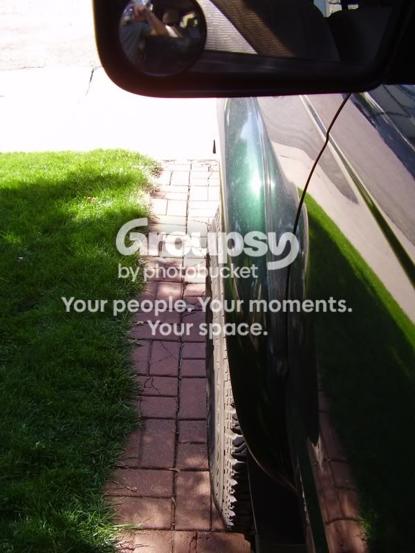

Looking out the drivers window at the front tire w/spacer

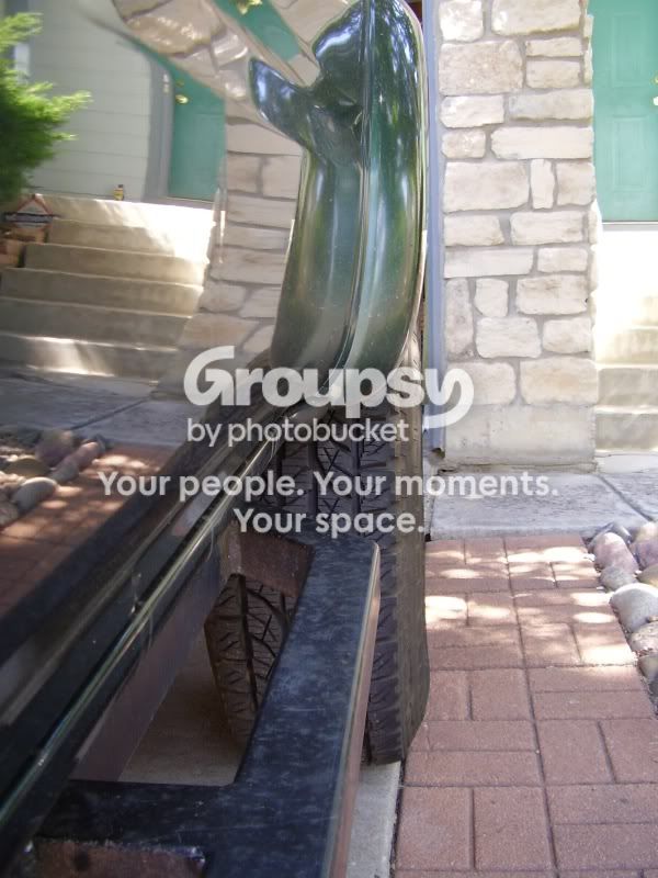

Rear w/o spacer

Rear w/spacer

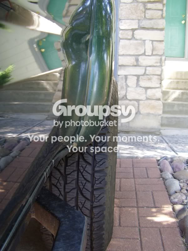

Front w/o spacer

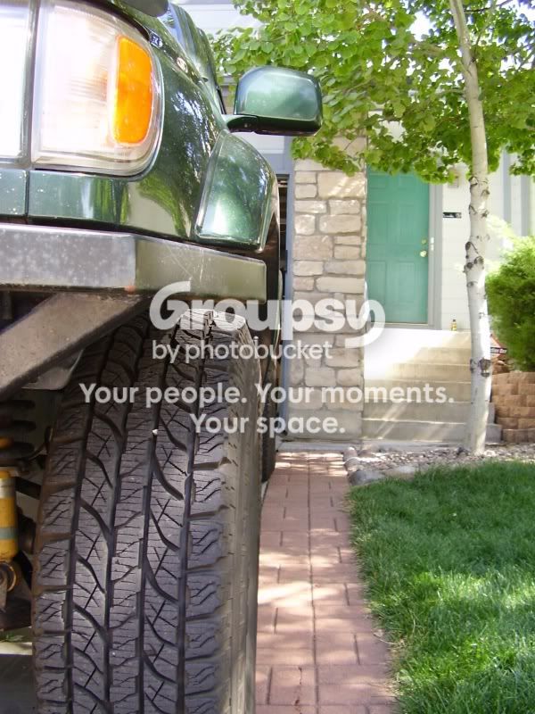

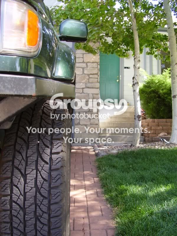

Front w/spacer
