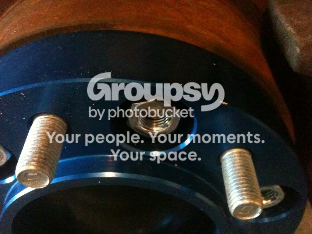

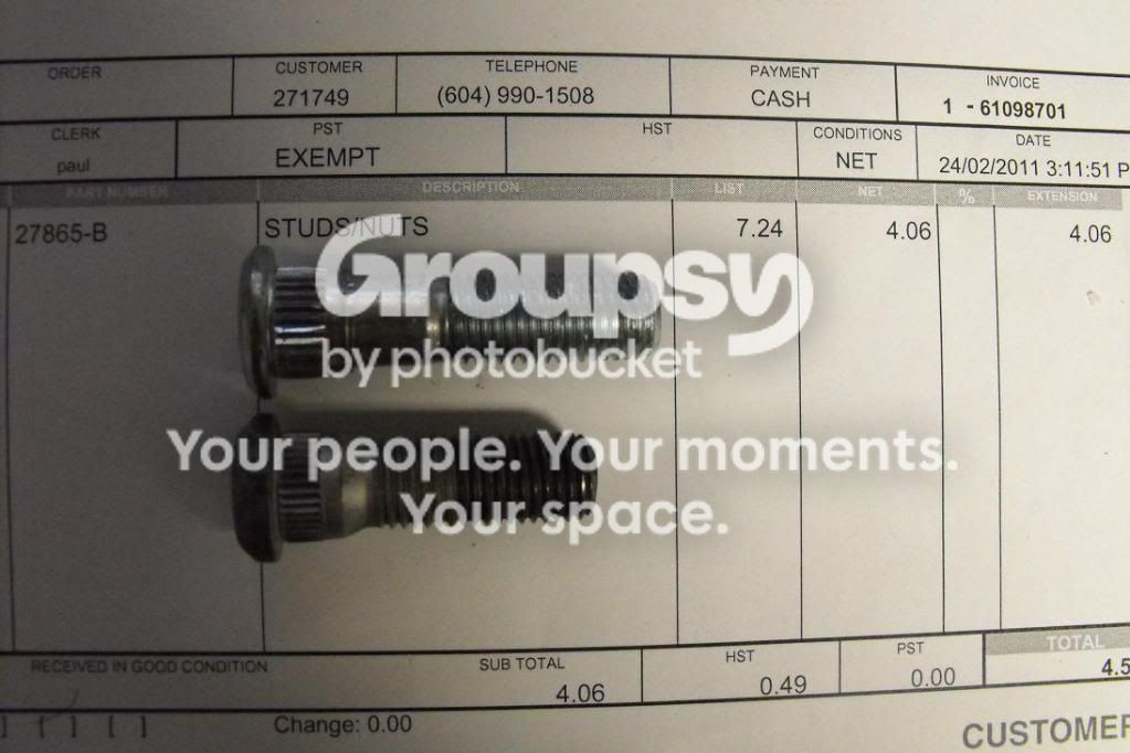

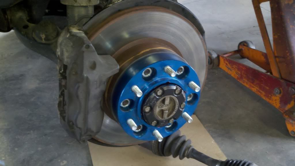

the other day i decided to throw on a set of 1.25" wheel spacers i had laying around, the back went on with no problems, and looked pretty bad $$$ but when i put them on the fronts i noticed that the studs barely came through the spacer, with the nuts on, the threads didnt even go all the way through the nut, now i am wondering if those of you who are running these ran into the same problem, if so did anyone rip everything apart and get longer studs.
I wouldn't worry about it. The front studs are shorter for some reason but the is enough thread for it to be mounted securely. I tried using the extended tread lug nuts but the shank is to big to fit through the spacer.
On mine the front studs were shorter then the rear but I had full thread engagement. If you have any threads showing on your nut, you need to go buy some longer studs.
