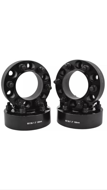

I was thinking of purchasing spacers from the forum in the classified sharing a link to a seller on eBay name rdcobra91. The sellers offer 1.25", 1.5", & 2" for under $140.
