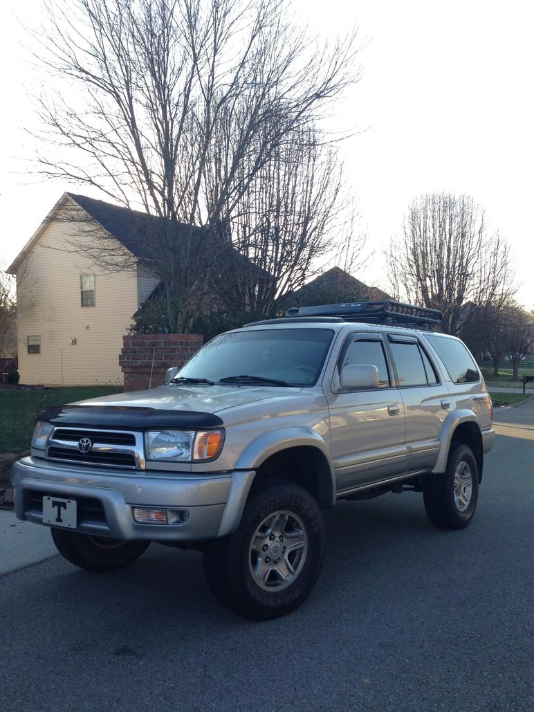

Here is a picture
Those are 16x7 ET15, iirc.
with a 1.25" spacer you should be sticking just past the fender roughly 2/3"-3/4" with 285/75/16 tires
