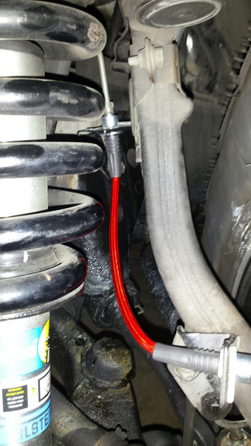

Hey guys just installed new SS brake lines from Wheelers and based on the picture the lines seem a little tight on full turn. I can imagine much more tension if full droop and full turn. Also i noticed these lines are shorter than stock. I have a SS 1.2 lift on the 3rd perch up front. Any thoughts? Thanks.

I have the same brake lines, they are very tight at full droop and the wheels turned. If I keep them I will lower the upper the upper brake tab down a little, there is enough room of the hard lines to drop them down a little.
Im going to call Wheelers on monday to see what the deal is. What do you think will happen if i remove the upper tab so there is more play? Do you think there would be too much tension for the hardlines?

I just made new brackets to bring the upper brake tabs exactly 1" outward and 3/4" downward. This is more than sufficient slack to relieve the tension off the brake line once drooped and at full turn.
The old mounting point marked with silver marker..
At full droop and full lock...no sway bar.

The 4Runner line is 19.5" and the Tundra is 21".
The one for the 4Runner is good for up to 3" of lift, maybe slightly more though.
