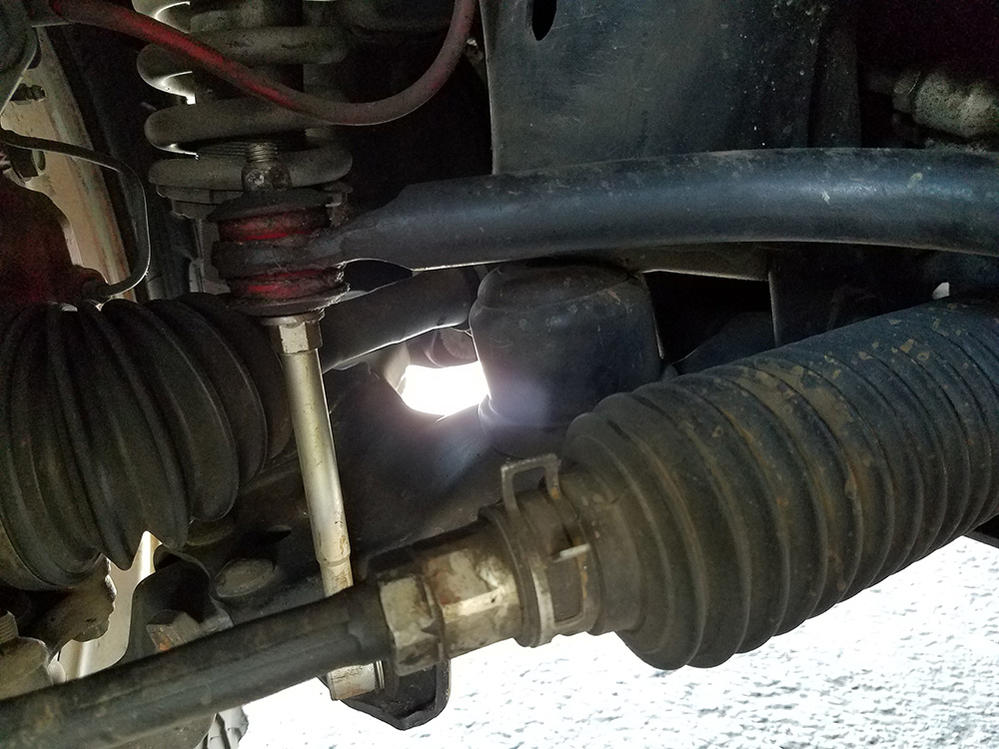

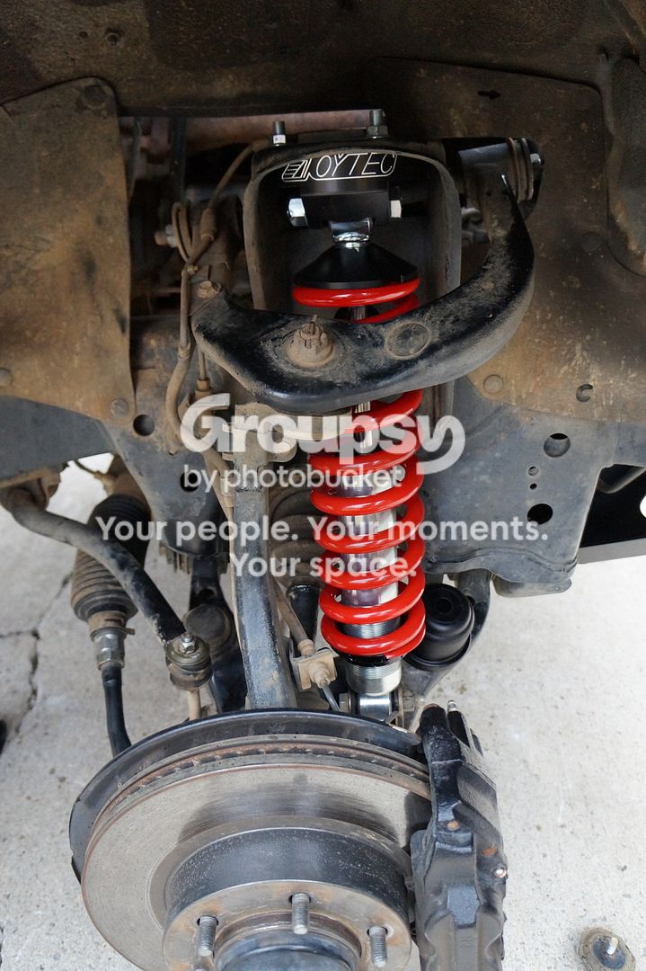

Those of you running Wheeler's superbumps on the front lca, did you install it on the rear of the lca like Wheeler's suggests or the front?
One of Unner's pics for reference.
I also got the wheelers superbumps installed up front. I know earlier in the thread I said that I called wheelers and they said to put the bumps on the rear of the LCA, but when I did this they didn't seem to sit very well back there. The rear of the LCA is skinnier than the front and a good bit of the bump was hanging off so I decided to put the stock one back on the back and put the new wheelers ones on the front of the LCA.

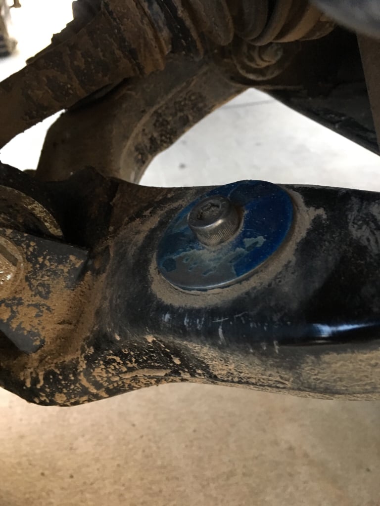

I do mostly go fast stuff too and that's when they seem to fail the quickest. I ordered them back in December '16. They are, from what I remember, the newest design. Here is a picture of the ones I'm running.
Nuts. I wonder if the temperature difference between here and there is the disconnect?
Hmm maybe... [emoji848]
Either way I'd still recommend them even if they are a consumable. I just wish I can make them last more than 6 months. Seems like I'm the odd one though since nobody else had these issues. To anyone reading this, buy them, it's worth it!

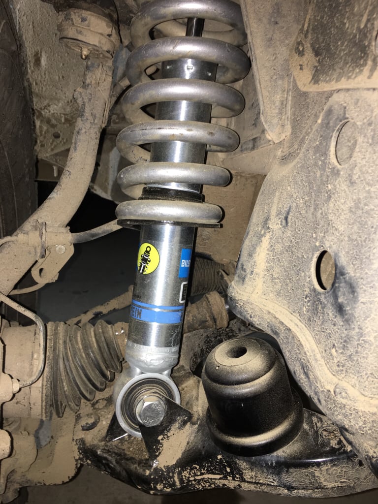

I do have the superbumps on the front LCA's. I did quite a bit of research on the installation and don't actually recall why they needed to be installed on the rear of the LCA. That's where I installed mine.
I also considered purchasing two sets for each LCA but ran across this thread: http://www.toyota-4runner.org/wheelers-off-road/138040-wheelers-superbumps.html
Here'a a picture of how they look installed on the rear. Not sure how long they'll last or if they really made that much of a difference.

I didn't read your post at first and was looking at that picture like damn, that looks like my suspension. But mine isn't that clean... Then I realized it is mine haha.
When I spoke with them they said to only install one so you still have one of the hard stock ones as a final limit on compression.
