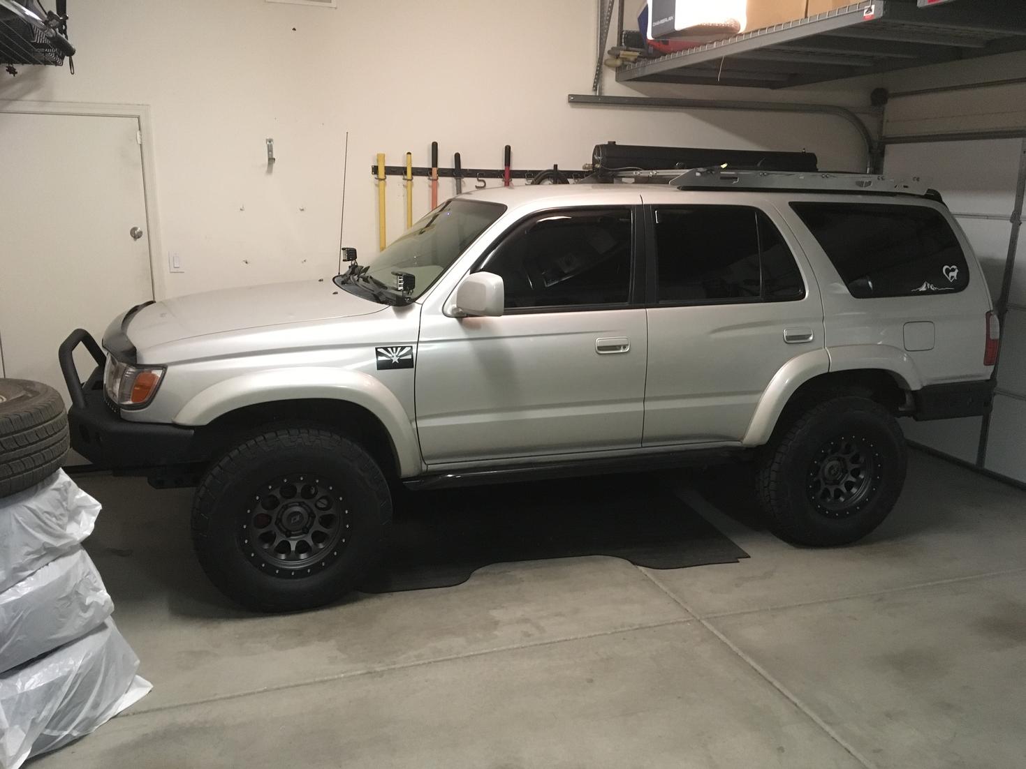

Maybe take a look at the Bilstein 6112 for the front as another option. That's the route I took with OME906/Bilstein 5100 rear. Shrockworks front bumper and Addicted rear bumper. The rear will be stiff without added weight. I have 2" lift with this set-up.
Bilstein 6112 front & OME906/Bilstein 5100 rear 265/75r16 tires.
I really like this ride height!
What front springs did you run?
edit: I see now its a coil/ shock combo duh....
Did you have any issues with rubbing/ did you run spacers?
