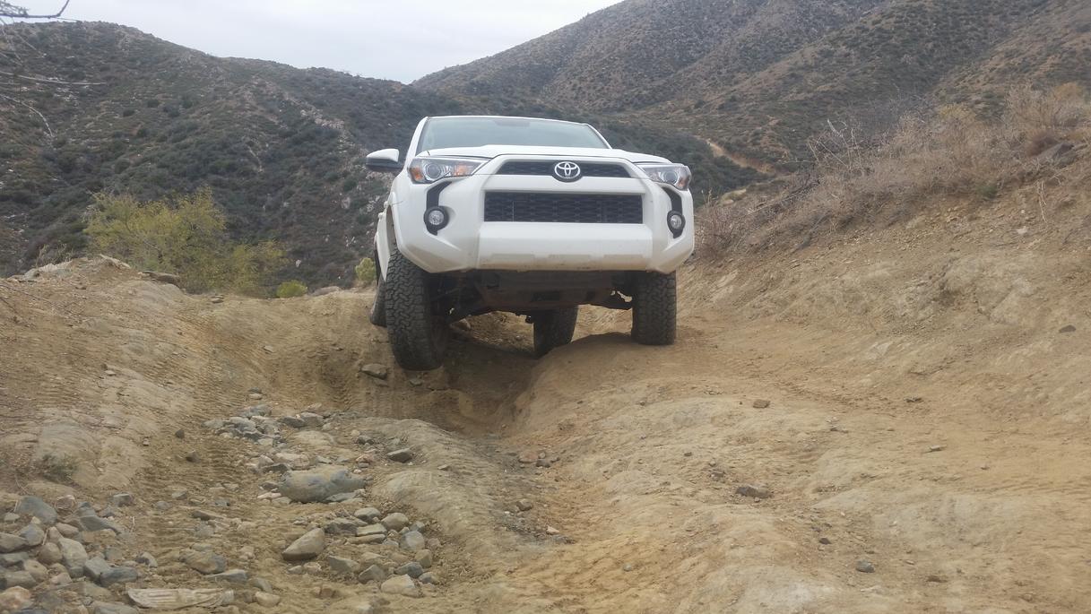

if you wheel with your front sway bar on youll have to rely on a locker or a trac to get you over some obstacles.
notice the 5th gen with sway bars lifting a tire a couple feet in the air. the a trac on the 5th gen is very good and was able to push him over the obstacle but he was on two tire for a second.

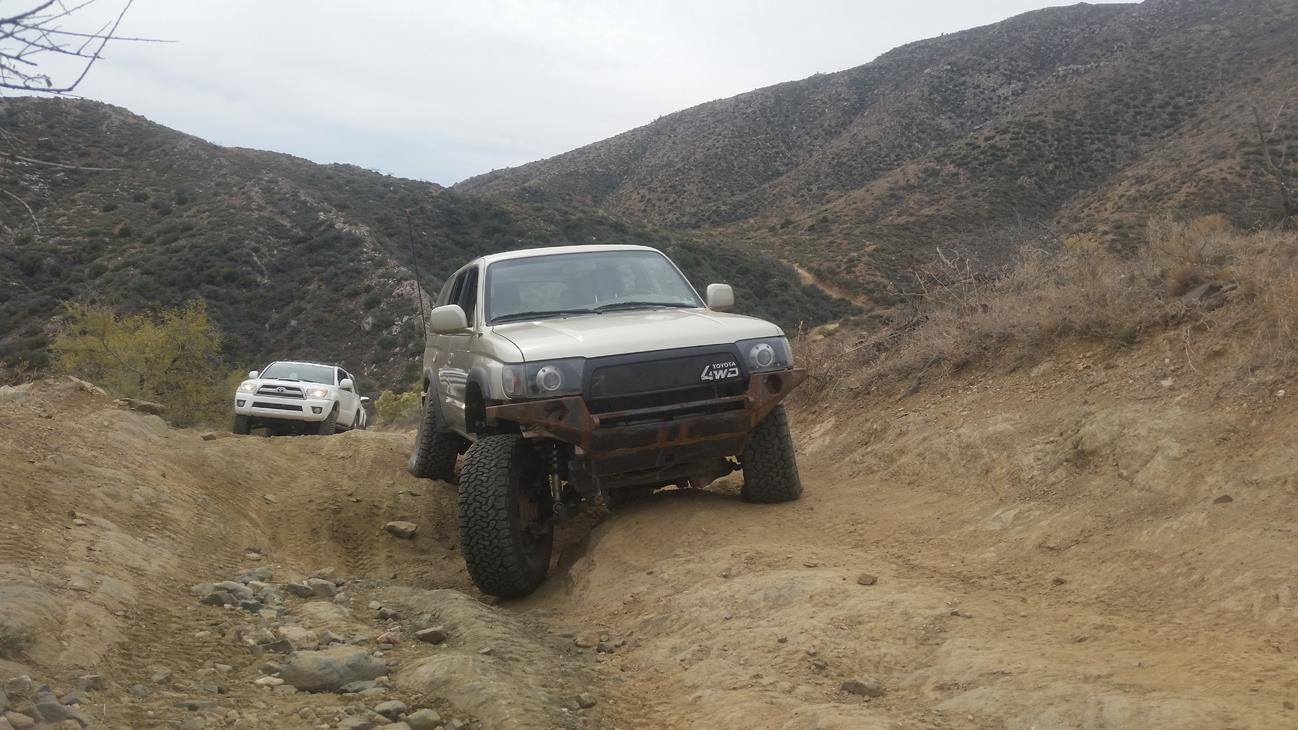

my rig drooping down into the dip here also didnt need the locker and my tires never left the ground. rear sway was on with 2nd gen rear links.
