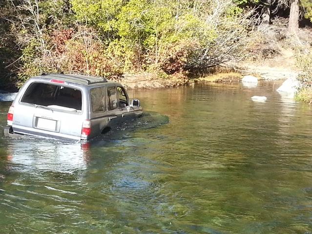

I did this last year, wasn't a good idea :crazy: Ended up with wet carpet and seats, water in the tranmission and bottom of my air filter was wet. I got very lucky.
Ha! That's where my trail adventure would end. Time to find another way. Lol.
