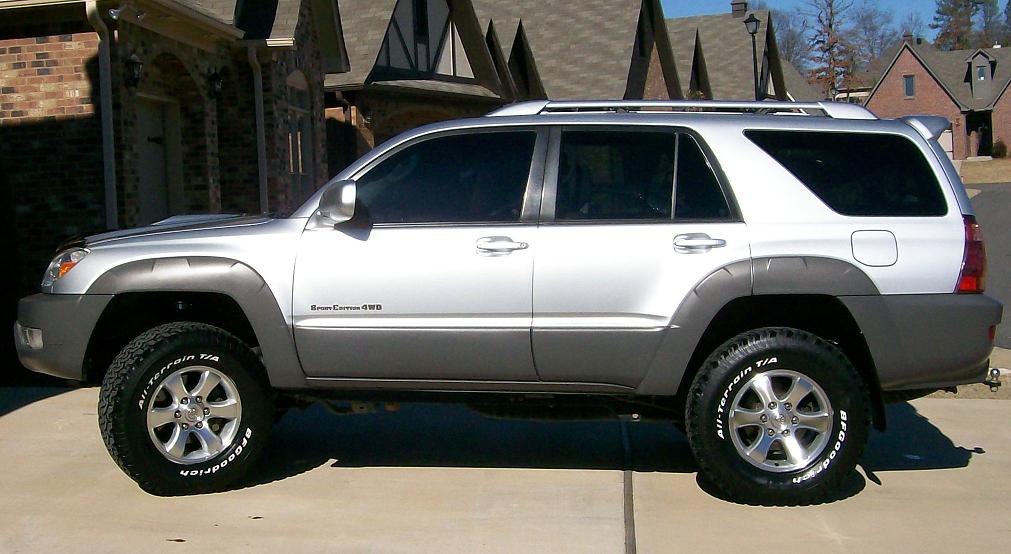

Hey Guys, I've got 122k miles on my 03 T4R SPORT with 3/2 cornfed and 285/70r/17 BFG KO's. I have had no probs at all and never had to replace a thing other than regular maint, like Brake PADS and all Fluids. I was talking to my wife just last night about what a great vehicle the T4R has been. It still runs and drives like the day i got it. I hope to hit 200k without any major repairs.
