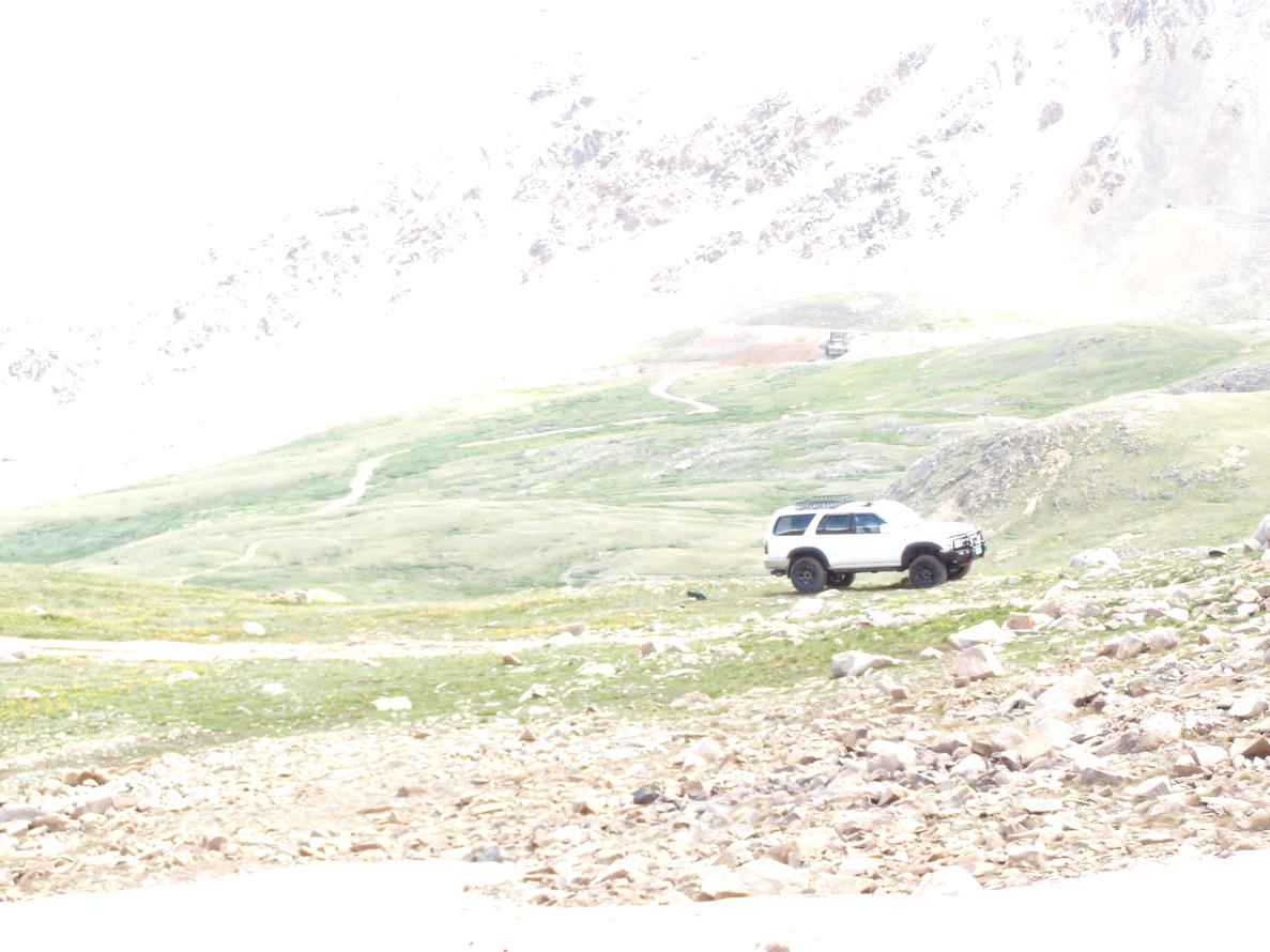

Last weekend I did Mosquito Pass and accidently started following some Jeep guys on a spur trail. I thought I was still on the pass road (give me a break it has been maybe 4 or 5 years since I did this trail) but it simply dead ended at a lake.
The last 30 feet up the trail was very steep and rutted to the down hill edge. I put the locker on at the bottom of the climb and climbed on up to where they were parked. Had I realized it was simply a dead end I would have just not even gone up the final 30 feet. Coming back down that same 30 feet was a pucker upper...
Here's a terrible picture of the area. The snow was so reflective in the sunshine I failed to adjust my lens accordingly and it whited everything out...
Here I am parked at the base of the last climb. There were 2 really deep water crossings just before this section and I was glad to have had my extra inch of body lift to keep my air box up and out of the water, with my deckplate closed up.
