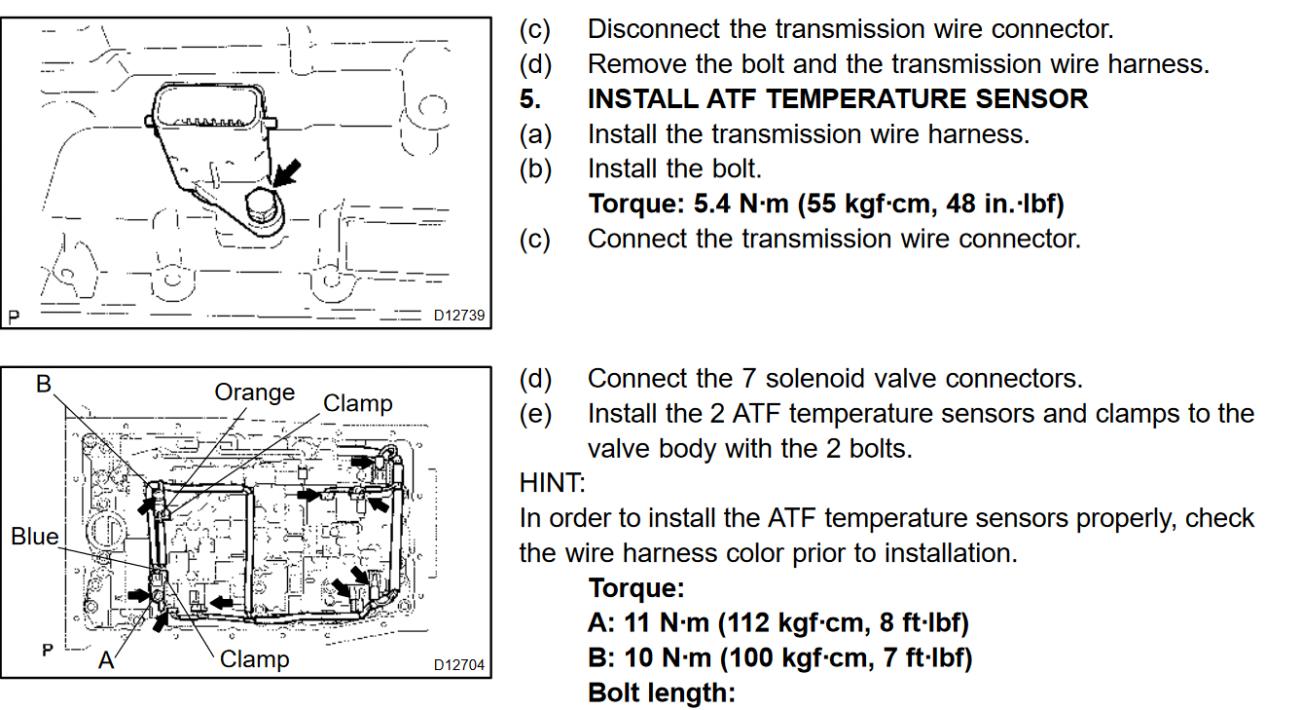

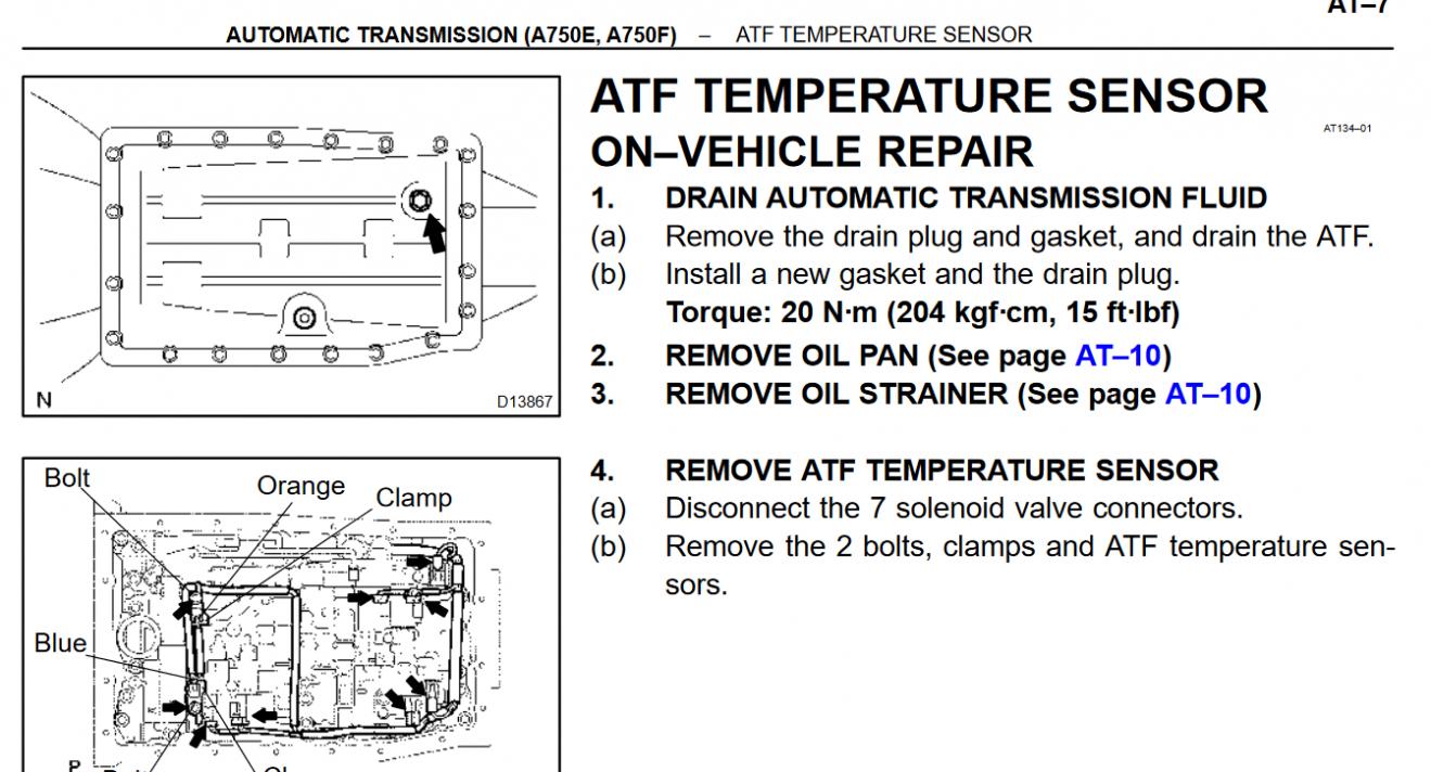

It appears the trans temp sensor is in the pan.
It's possible your problem may be corrosion in the wiring and the mechanic may have bumped something that caused the connection to fail.
This would also support your theory of the hard shift into drive being caused by a wiring issue as well.

Hi there,
Sorry I had a lot going on, I bought my mom a lexus NX 350H so she is safe and this will turn to my project car... and now can dive into this more deeply. I don't like to walk away from a fight. lol.
Question I'm trying to narrow down on this issue. This seems like it can go the easy or the hardware. Hopefully there is an easy way.
I got both p0711 p0713 which point to transmission codes.
So looks like blue and orange are the wires of interest. Is there a pin out diagram ? I've been searching all over google but maybe I'm looking in the wrong places. but i can't seem to find a wiring diagram.
Is this just a resistance based temp sensor ? any way to probe from the engine bay?
also to confirm the transmission harness is where the sensor signal passes through. My plan was to try and divide and concur from the transmission harness to ecu and transmission harness body to the sensor.
At all cost I don't want to deal with dropping the pan.
I feel if I tackle this scary problem first, the rest of the car problems will be easy.

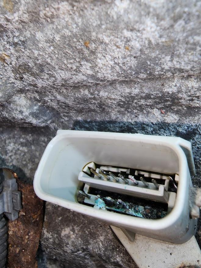

Unfortunately the transmission wiring harness is done! =[

I know the transmission harness seems daunting but it really isn’t. Neither is dropping the pan. You are going to need a solenoid harness and Toyota replacement pins.
I used this page as a guide: Preventative Maintenance 2006 DC 4.7 A750E P0986 & P2716 Transmission Problem | Toyota Tundra Forums
If you can solder you can do this. I ended up depinning and splicing 3 wires. It’s possible you might need to do a couple more based on your image. Let me know if you need any clarifications or have questions. I did mine (v6) at 175 and it just hit 200k with no issue.

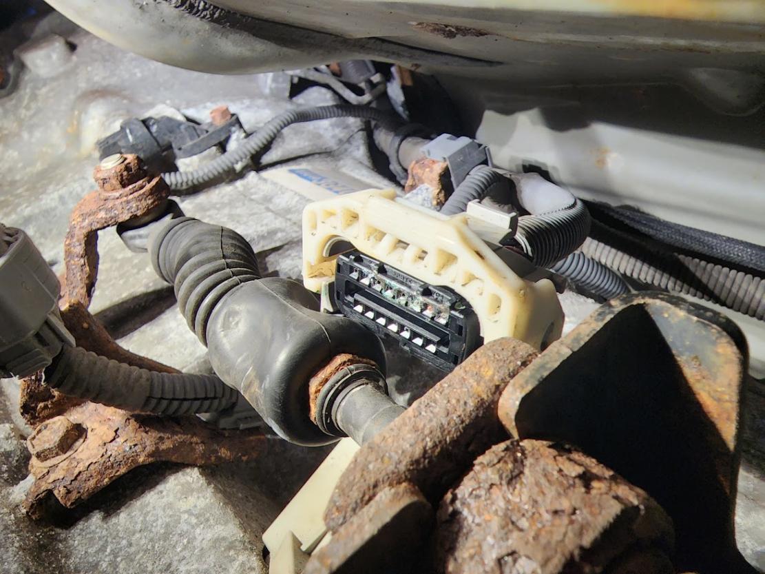

Just want to let every one know 4runner lives to see another day. it was brutal. cut the floor board cuz doing this on the floor with barely an access . it was hard enough to do it from above...
basically followed a few videos out there. I saw someones youtube video where you can cut the floor board.
transmission harness going to the ecu had so many wires that just snapped when you touched it.
so i just cut the wires bought new transmission harness on amazon, and but splice + heat shrink wire and wired it up
I use 23 pin nails from my nailing gun and drowned it fluid film and hoped it worked. if someone in the future is reading this, you can full set the pin in and just shy of flush snip it. should be more than enough to make up contact.
it takes several tries to get it right. . but eventually you will get no codes.
its also a mother lover to get disconnected the first time.
