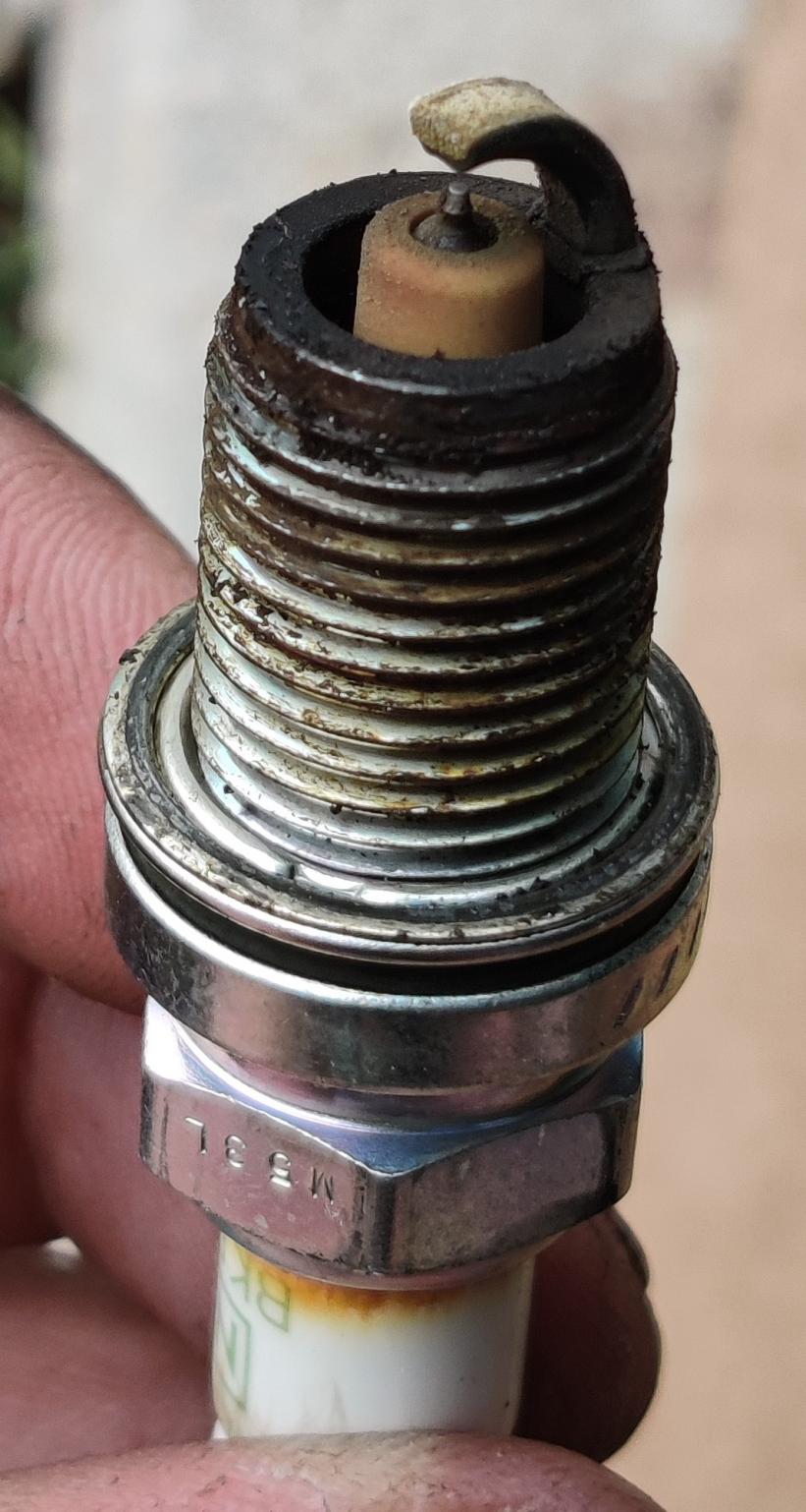

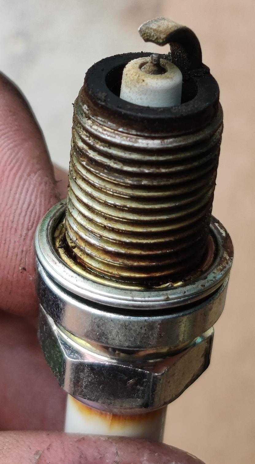

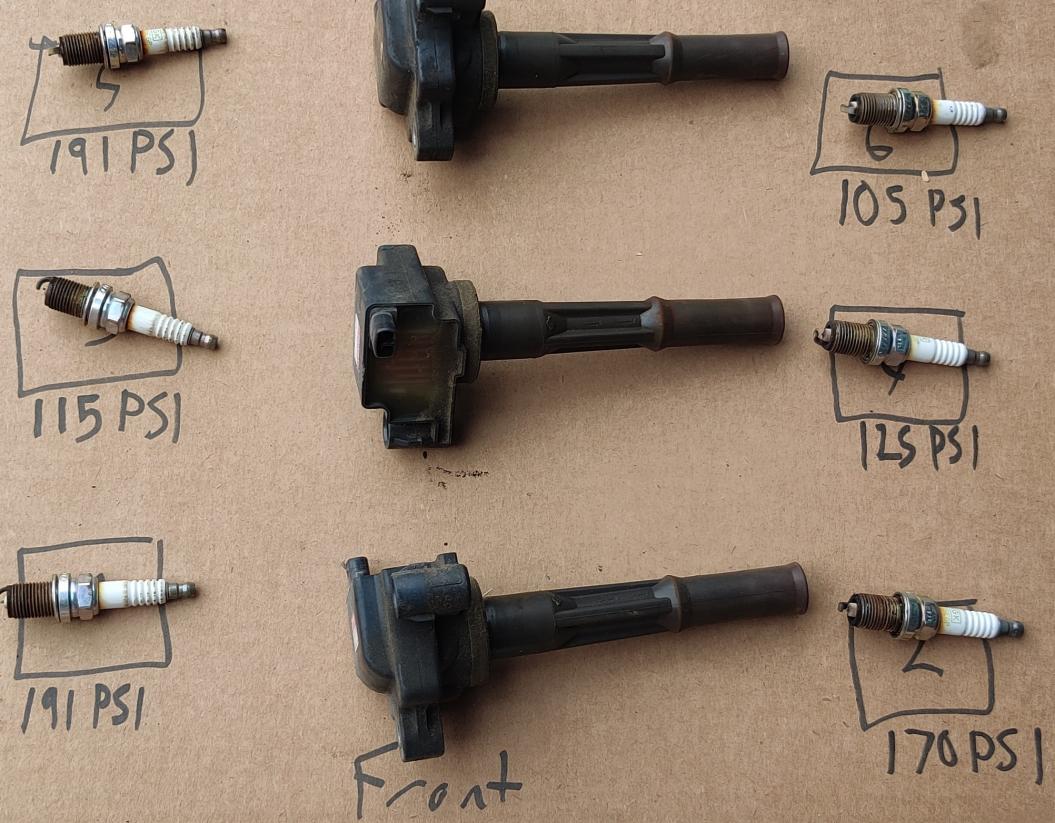

I just finished doing the compression test. I followed the Timmy The Toolman's video. He states the book says 174PSI minimum and no more than 15PSI difference.
I attached 2 plugs. The dirtier of the 2 is the 115PSI plug and the cleaner one is the 191PSI.

jeez man no wonder your 4runner feels sluggish, thats some serious compression loss. id check your valve seats and your valves to see if any of them are burnt. your piston rings could also be fried as well so yeah it may be time for a rebuild. if you have the tools you could do it yourself, rebuilding engines can be a good time.

Well there's ya problem! :target:

But did you see the pics I posted? Its so hard to know who to listen to. You're saying that but I've had people on here say the complete opposite (look at the responses since my compression test pictures). And 2 people I've spoke to in person today suggested a rebuild. Why would an o2 sensor cause compression 65PSI below Toyotas minimum on multiple plugs?

I also second a valve adjustment. I would not pay a shop to do it though as many of them will charge enormous labor costs because it's a complete pain to do. I've done it 3 times and it takes a lot of patience. You may also have one or more cracked valves, which in that case no amount of adjustment and shim swapping will get the lost compression back. Unfortunately the only way to find a cracked valve is to pull the cylinder heads off as even a leakdown pressure test won't tell you whether the valve is out of adjustment or if it is cracked..
Your bottom end most likely is rock solid but the valve in the heads need some R&R to get that power back online. I drove for 4 years with one cylinder at around 90 PSI, but 3 cylinders is a bit much.

I would recommend a leak down test on your cylinders with low compression. Adjusting valve lash isn't going to help if the problem is worn piston rings.
