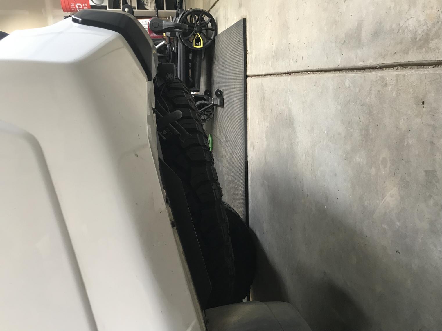

I'm new to this truck but before I buy a full size spare my plan is to just take a wheel off and swap it with the spare to see if it fits. Won't take much effort and a non-emergency is a good time to practice... even if it doesn't fit.
I in fact just put a 285/70/17 in the spare spot. Fit with no issues. Better safe than sorry
