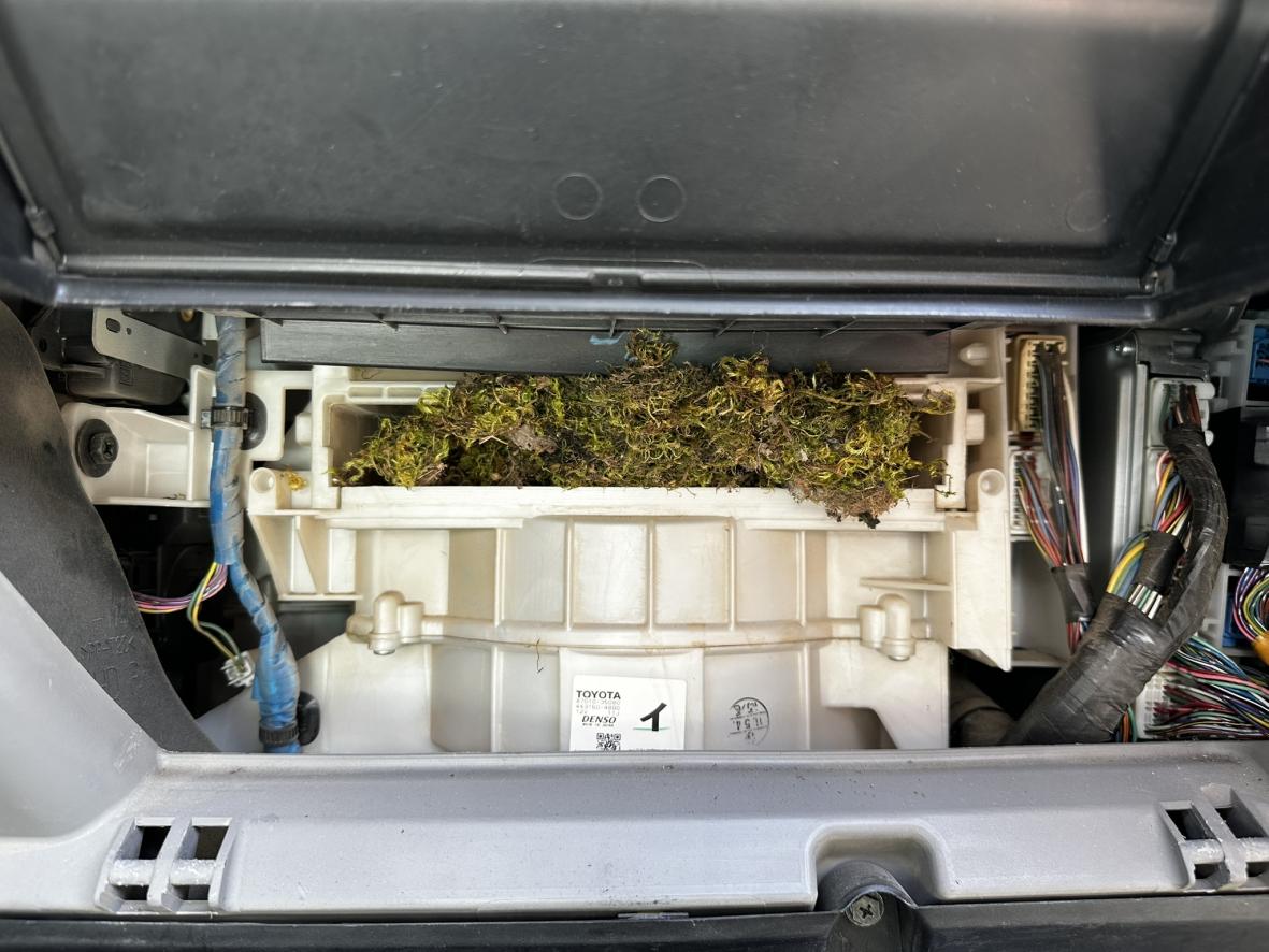

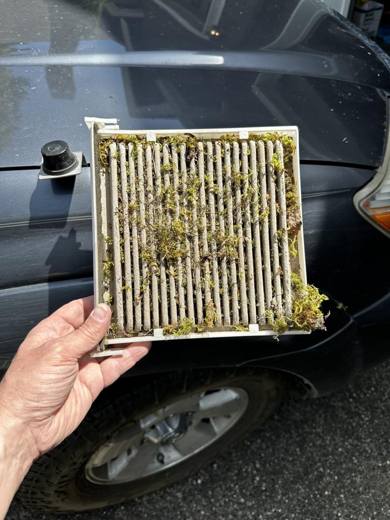

S shine Member Jul 5, 2025 #1 ...it's time to check the cabin air filter Attachments IMG_6508.jpg 137.4 KB · Views: 137 IMG_6509.jpg 131.3 KB · Views: 122
AuSeeker Elite Member Jul 6, 2025 #2 shine said: ...it's time to check the cabin air filter Click to expand... Looks like you have a rodent problem!!! You might want to put some 1/4" hardware cloth over the outside vent hole under the cowling to keep them from getting in to the cabin filter area!
D dasx86 Member Jul 7, 2025 #3 AuSeeker said: Looks like you have a rodent problem!!! You might want to put some 1/4" hardware cloth over the outside vent hole under the cowling to keep them from getting in to the cabin filter area! Click to expand... That's what I did - I followed someone on here's lead (maybe it was you?) Silicone gel around the lip of the opening, put down a piece of mesh that's cut to shape, then more silicone gel.... no more rodent issues again
