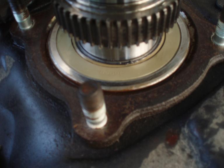

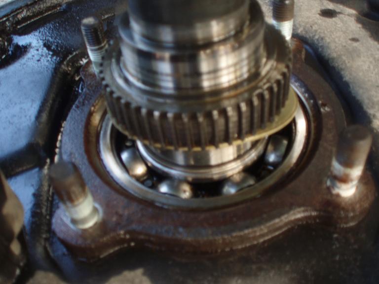

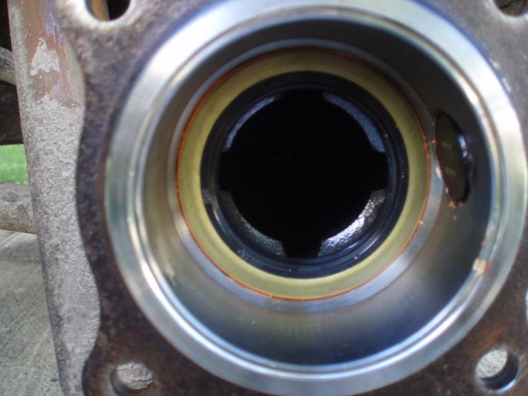

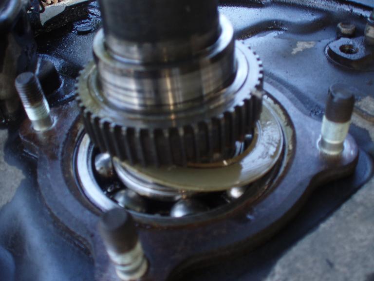

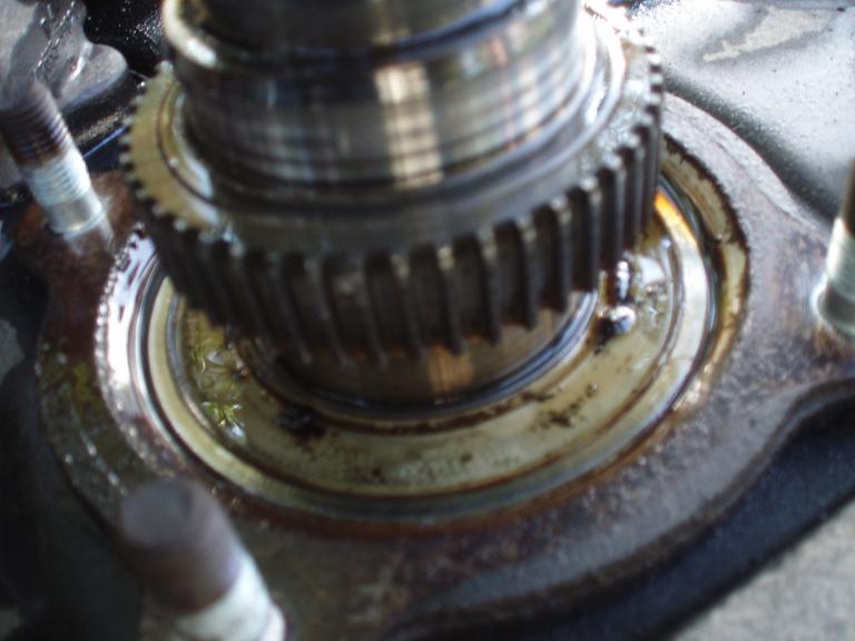

Anyway here are some of the pics I took last night (before dark obviously).
Pics in order of:
1) axle out
2) new seal in place
3) seal loose
4) seal lifted
5) greased/sealed/put back

Z4R, thanks for those pics! Ah-ha... so you *can* get to the bearing cover with the bearing still in place. That's good to know for the future, possibly near future in my case.
Pics in order of:
1) axle out
3) seal loose
4) seal lifted
Great pics. Didn't realize you could get that cover off. How did you pry it up without damaging the seal?
Great pics z4r. I plan on doing my seal this week. Hope I dont have to do the wheel bearing, the wheel seems sturdy but I wont know for sure untill I open it up.
Nice to see the bearings aswell :naughty:
