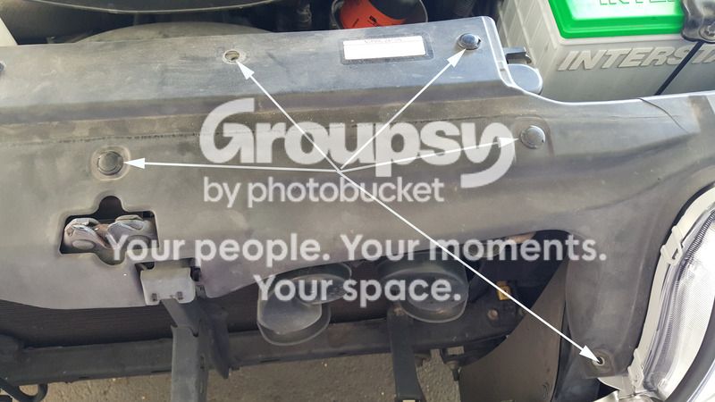

Does anyone know the part number and where I can buy these push type retainers for a 2006 4Runner Limited. There are all different kinds for sale all over the internet, but I can't figure out which ones to buy.

You can get them from Toyota, but expect to pay around $5 each or you can take one of them into Advance, Autozone, etc and match them up. They probably don't have the exact same one, but you can get one that is close.
I bought mine from Toyota, they were .85 each. Is it really worth buying some aftermarket part that might now fit right to save $1
Lowes and Home Depot also carry them in various sizes...I bought a few different sizes and keep them in the car for when they randomly break.

I second this. I found the 1/4" Nylon push rivets from Home Depot were way better than stock, could be removed easily without breaking, and felt way more secure.
I bought mine from ebay. They where shipped from China. It came in less then two weeks. The only thing they about them it they had grey push tops vs black for OEM. But you cant beat it 10 for under 4 bucks.
I kept breaking those tabs while I was retrofitting my headlights.
I just zip tied the two holes on the far left and right ends. No problems since.
I broke a few of those when i puled my headlights to black them out. Ordered these on a whim and a couple searches that pointed towards a nissan part that fit. They fit perfect and replaced the ones that weren't broken just so they'd be fresh non brittle plastic. Can't beat the price either, much better than almost a buck a piece from the stealership.

$4.00 for 50 and I think I will be able to fasten the whole truck back together, a few times.

Mine was missing a few as well, and I also found them on Ebay.
(local auto parts stores didn't have the exact size)
I paid $2.89 for 25 and free shipping.
Search Ebay for "plastic push rivets for toyota"
the dimensions are about 7mm wide shaft, 20mm wide head, and 8mm long.
