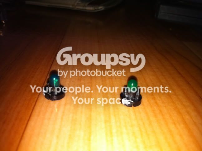

I tried the ones from superbright led and those didn't work maybe I got the wrong ones? Anyone know of the type and what website I can purchase these at? Or if I can get them at the dealer? My backwindow and AC cluster bulbs went out.
IMG_2437.jpg~original
Try here. They're neo wedge bulbs and are either type A or B. Just measure the base to see which one. The green color filters can be pulled off to use on a replacement bulb.
